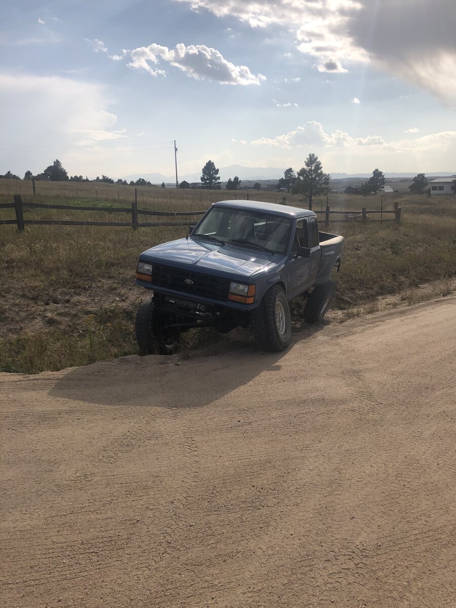

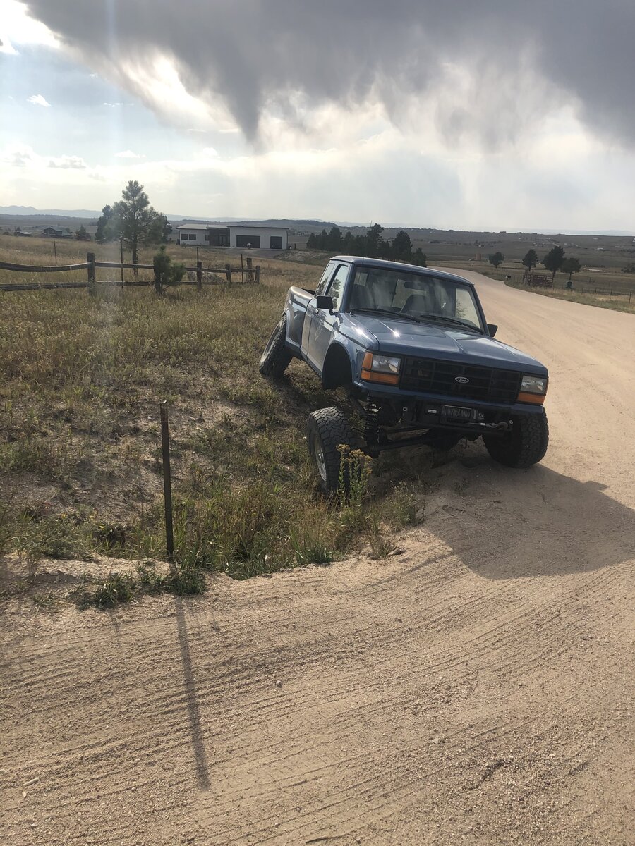

Went out to my dads today and he has a perfect spot to cycle the suspension so I did and measure for shocks.
She still has it. Tucks and travels really nice. The bilstiens were really the perfect length. 18" compressed was perfect and fully extended is about 28".
I decided to go with a little longer shock. I am going to hack off the lower mount anyway, so I will move the lower mount down a bit. This will give me a little more travel available. I really need to do air bumps at some point anyway, but for now I will be sure I am not maxing out my shocks.
I got my buddy Ed to order me 2 shocks today. They are 10 days out. Went with the performance series 2.0 smooth bodies. Part #
985-24-006 19.65 inches compressed and 31.75 inches extended 12" travel shocks.
