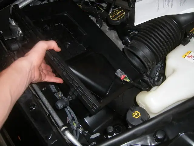

First off, the instillation took me about 30 minutes, mainly because the instructions dont explain in enough detail how to remove the stock air box, so im going to post a quick picture tutorial for anyone else who might need it.

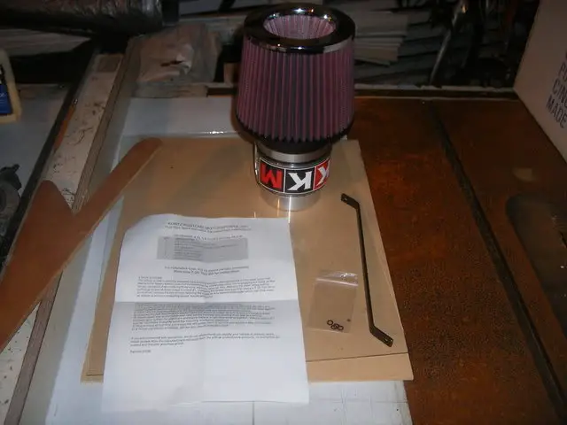

the kit includes the intake, instructions, a support bar, and some washers. The instructions are great until it starts talking about removing the lower half of the airbox, which is held in place mainly by two rubber "lugs". These things suck because theyre rubber, and they fit snuggly into the steel running along the fender. Not only that but you have to lift the box up and out at the same time, using a lot of force to get these stupid things out of their little hole. (see the pictures so see what im talkng about).
The trick is not to be shy about putting all of your weight into this box and youll be done in no time.
After that the instructions are great and it takes about 3 minutes to get it all hooked up and going. if anyone needs, i can post more pictures, but thats all i think youll need.
