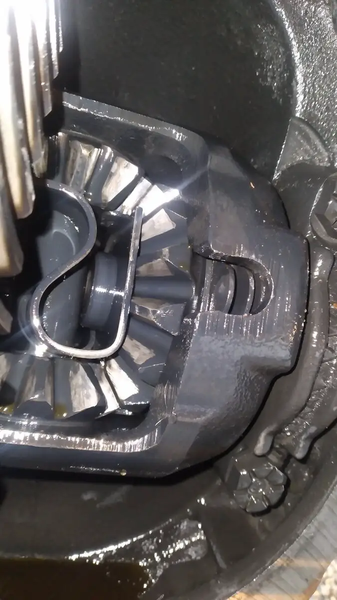

- 99 Explorer EB 4.0 SOHC
When accelerating, I hear a loud knock or pop noise coming from the drivetrain. I pulled the rear diff cover off and the ring & pinion looked good. Some of the spider gears looked pitted, but none broken, and no sign of metal shavings. I dropped the front driveshaft and the noise was still present. It only happens when you give it gas, and it occurs when driving in a straight line, not necessarily when turning. The noise is extremely loud. It's a 99 EB 4x4 with a 4:10 limited slip rear end
