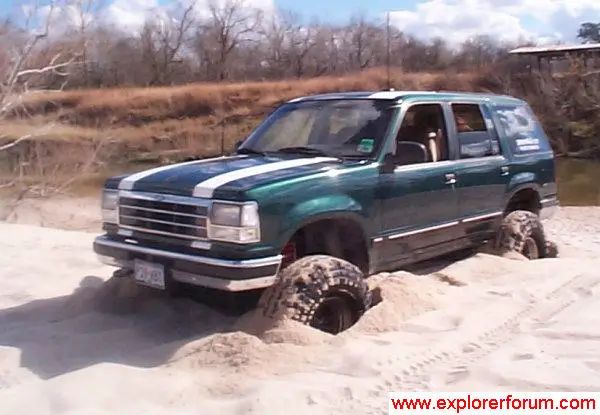

Here is a picture of us loading the monster on the trailer to get here home to Victoria Tx where the 2wd will under go a complete rebuild. I will keep every one posted as the project comes about. The plans might change since the truck needs a lot of work. I would also like to Thank Michael and Randall for all there help getting the Truck to its new home.
Here are the Plans for the Explorer:
T-case: BW 13-54 manual t-case
Front:
Dana 35
extended Radius arms.
Skyjacker Lift
1" body lift to clear future Atlas 2
5.13 gears
ez-locker.
I am also looking into stronger axle shafts.
Warn manual hubs
Rear: 8.8 5.13 gears with powertrax locker from Navajo
rear disc brakes
