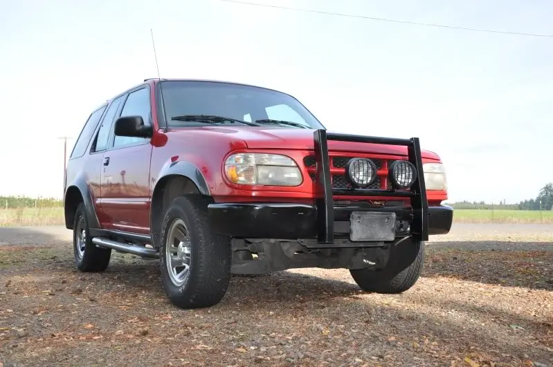

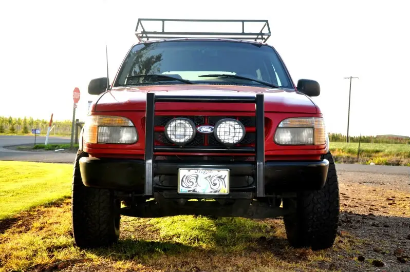

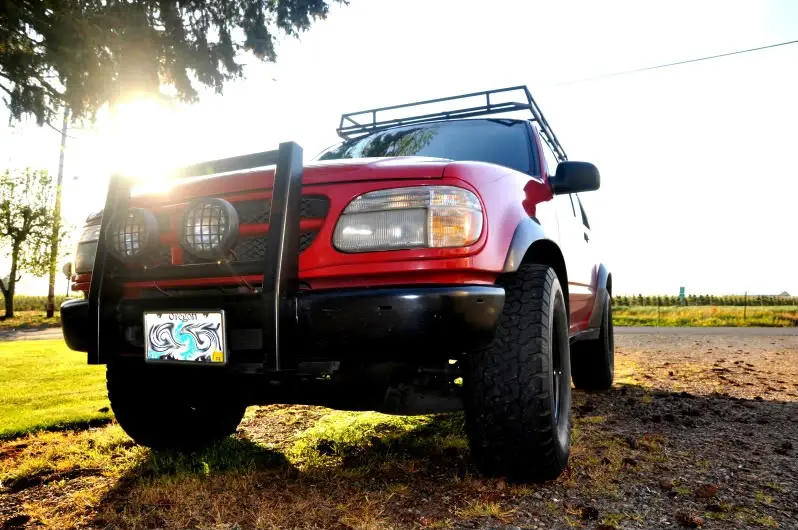

I forgot to update this after my custom bumper install!!
this is the thread I made when I was figuring out what I was doing.
I'm already starting plans on a custom rear bumper with swingout tire carrier, heavy duty roof rack/basket with four lights up top, and a second battery with fused power outlets.

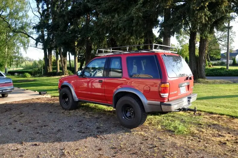

I got a little birthday present for myself today! I bought some used BFG All Terrains in 31x10.5x15 for $30. the rims they are on dont fit my truck, so I ordered some Cragar V-5 black steelies. they are similar to the Soft 8s, but I hadn't seen anyone else running them and they were a little bit cheaper. I got them for $196 shipped to my door! I got the 3.75 backspacing, and I suspect I'll need to do a LITTLE bit of trimming on one spot. they should fit nice and look great, so we'll see in a few days.
I've also been sourcing some parts for my 4WD swap. Located a tranny, hopefully I can get a good price on it. and I have a lead on a front diff for cheap. If I can find a 1354M and driveshafts after I get the tranny I should be able to do half of the swap really soon. then I'd be waiting on money to finish out the front suspension and call it good. time will tell.
OH!! and I got my Private Pilots License last Tuesday! not only do I feel way more accomplished, but it frees up a little spending money for my explorer!! :D

I got my wheels today! they look sweet! simple, but better than factory cuz I'm not much of a chrome fan. I wont be able to get them mounted yet. but I checked clearances and they fit great! can't wait to get tires on em :D
oh, and I took the running boards off today. I've never actually used them cuz I'm 6'2", and I found out yesterday that my short little brother didn't use them either. I decided to chuck them, so I did. pictures after the tires are mounted.
