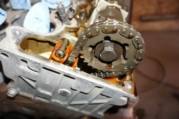

Well I have started and seem to have a small problem with the 105K miles used engine. In the attached photo of the rear chain of this VIN "E" 4.0L SOHC engine from a 2008 Ranger 4x4, the right side of the chain (facing hydraulic tensioner) is tight, but the side facing the upper cassette bolt or intake manifold is quite slack, about 3/8" of play . The front chain is tight on both sides so I'm wondering if this is an indication of trouble ahead for the rear chain and should I just go ahead and replace it plus gears? I did look at the videos and there does not appear to be any slack on either side when they are replaced... Thanks in advance...

I don't see any problems in your pic take a good picture down in the head so we can see the bottom of the guide where it is attached
Hope this helps

I'm not at the shop (about 85 miles away) and the only other photo I have is attached, there are no broken pieces and we don't hear any odd noises when we spin this engine over with a large drill.
You know, it just occurred to me that perhaps we could fill the engine with oil and turn it over until we get oil pressure, just to see if the rear chain tightens up on the other side, what do you think?
This will work lots of members do this to start their truck with no rattle takes about 5 seconds at starter speed
Your pic shows no damage I can see
