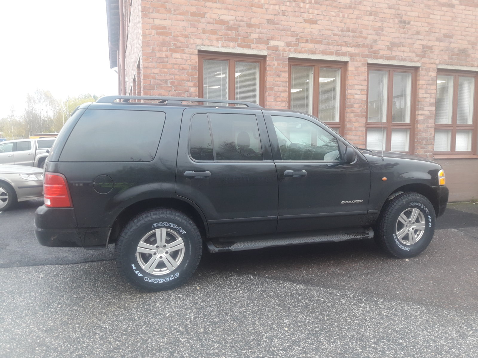

Just got 265 / 75 R 16 Hankook Dynapros on my 2004 XLT. No rubbing so far with my normal cargo or passenger, not even when wheels turned to max. Haven't checked speedometer. Looks much better with bigger tires. Will be interesting to see what happens at winter time, whether snow and ice will pack into wheel well and cause rubbing? So far, happy with 265/75R15 :)
Also, replaced TPMS sensors, got original Schrader (or very good chinese copy) for 13€/piece from eBay. Part numbers were
4L2T-1A150-BA
4L2T-1A150-BB
Not sure, what's the difference between BA and BB, dealer said it's interchangeable.
With new 265/75R16
