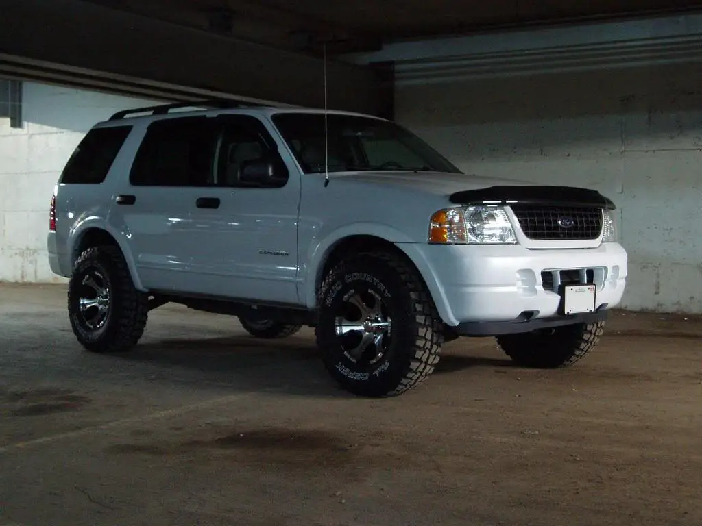

Any pictures of a 3rd gen with 265/75 tires without a lift. I have an 06 Eddie and would like to put on the largest tire possible, without having to lift?
I had seen this on the forums, hope the owner doesn't mind me posting,
This is the exact look I want to go for without a lift i.e wheels & tire look, is it possible. Thank you, and any ideas are appreciated.

That's Roadbully. Those are 285's with a 3" lift. Click on the Elite Regitry link in my sig and you'll see pics my 05 EB on 265/75/16's with no lift.

Wow I really like those tires. How do they hold up on the snow? Are they good to use all year round ? And Would they fit an '06 EB without any modifications? Thanks.

** The picture in the original post (dated last year) is RoadBully's ride **
He is using 285/75/16 tires on Dick Cepek DC-1 rims with a -12mm offset. It's worth mentioning that in that picture, he is using a 3" body lift....he now also have a 3" RoadBully spacer lift for a total of 6" of lift...so the truck is a lot higher.
To answer your other question, yes you can fit 265/75's without a lift, on stock rims. However if you go with MT style tires, expect some rubbing while steering and possibly a little rubbing in the rear if you have running boards. If you go with AT style tires you should clear.
Keep searching around the forums, there are a few members here who have posted their stock X's on 265/75/16 tires.

Stock suspension, 265/75/16 DC Mud Country's. MILD rubbing at full lock.
Next is a Roadbully 2.25"x1.75" lift and 285/70/17's.
