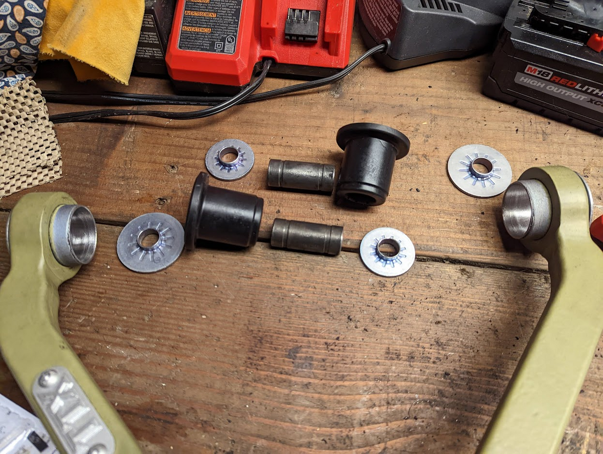

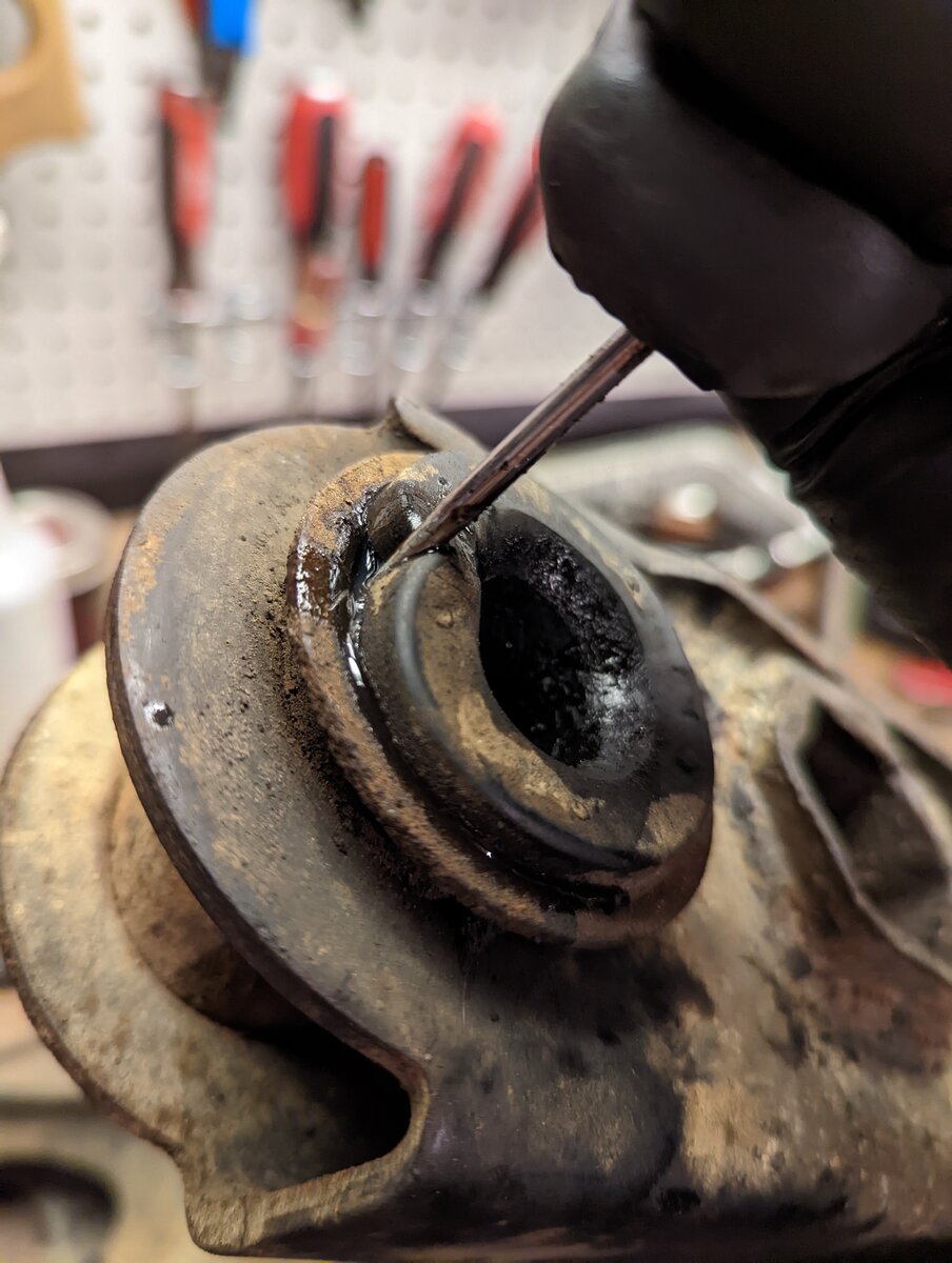

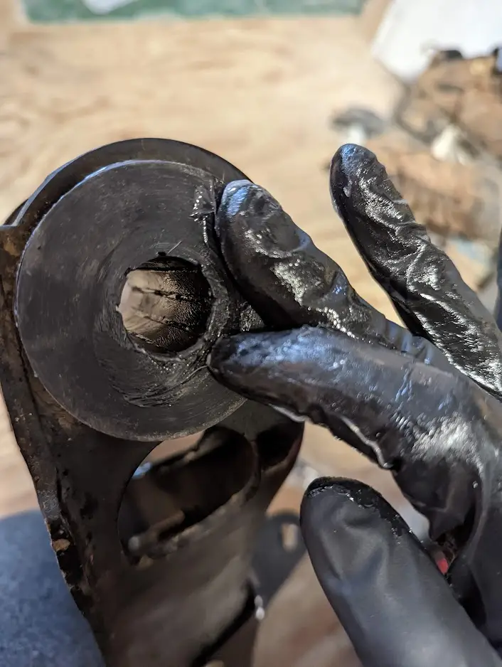

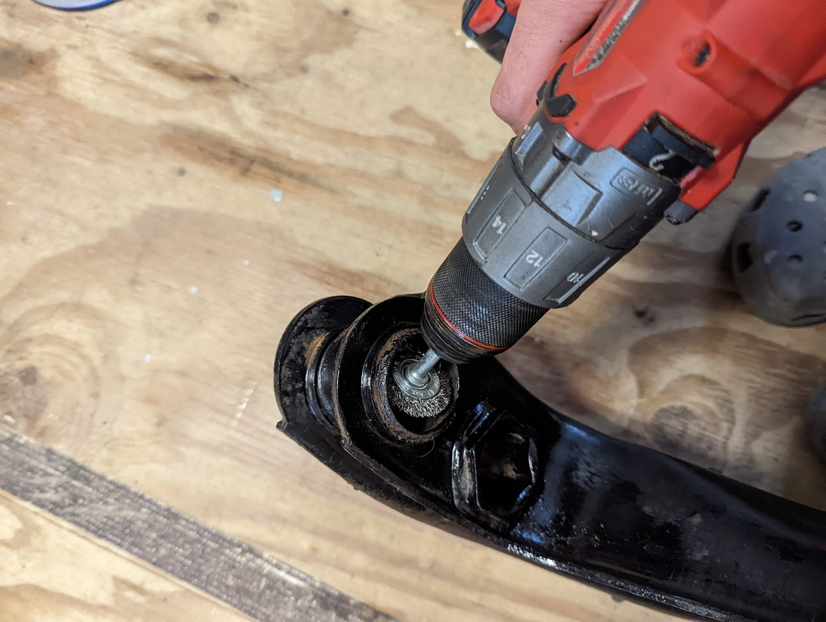

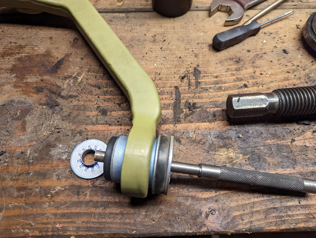

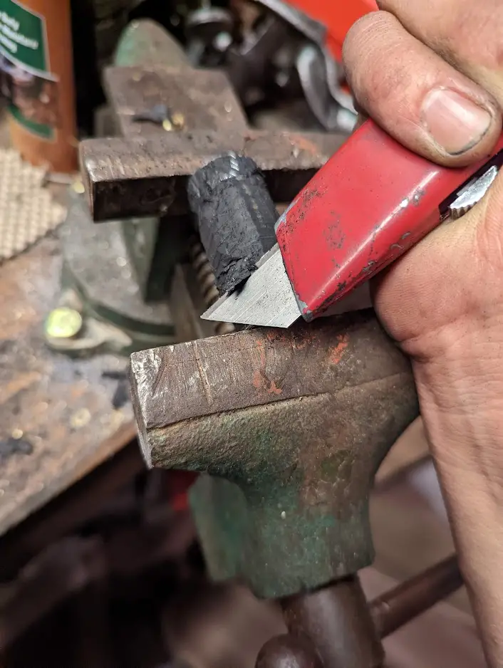

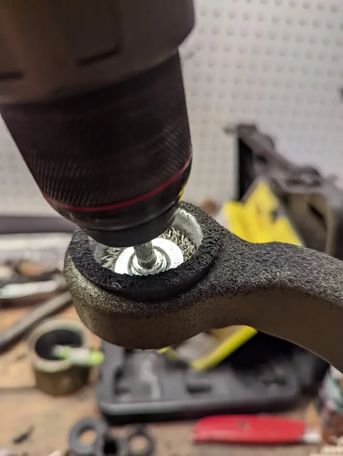

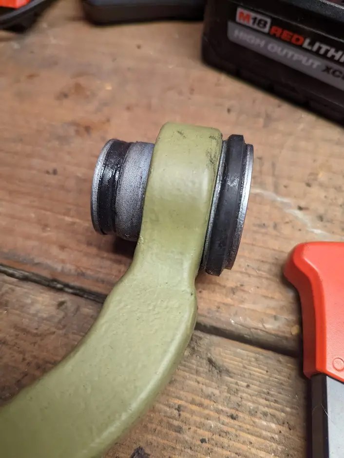

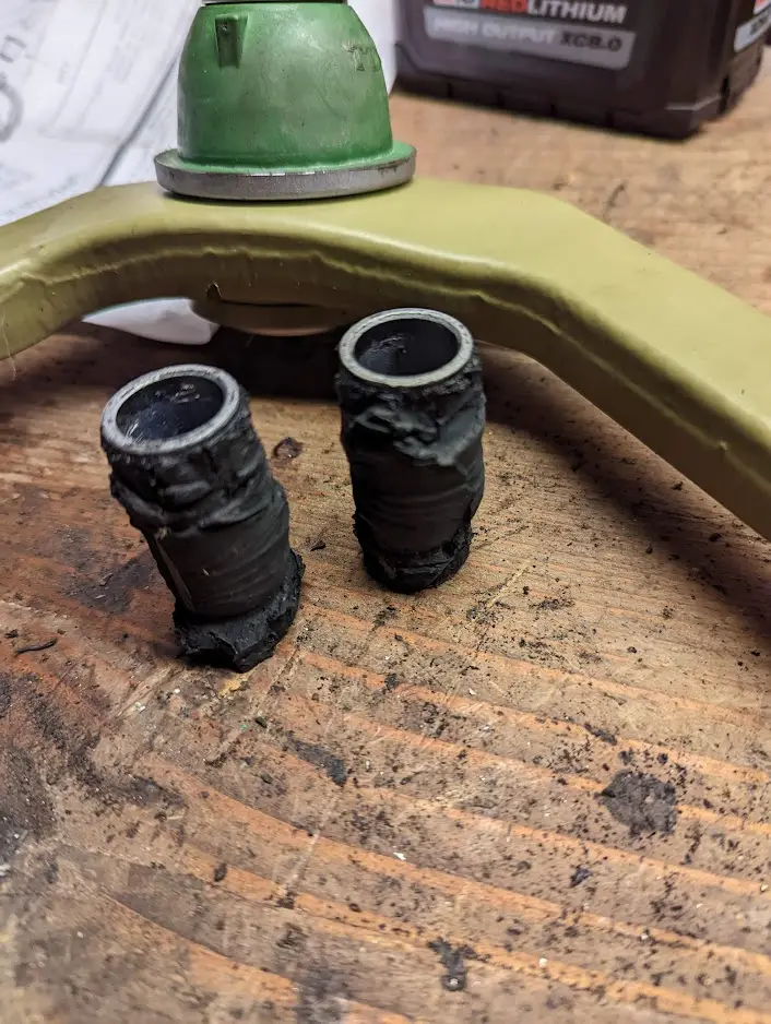

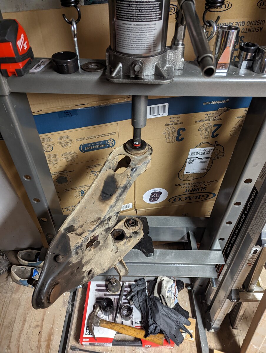

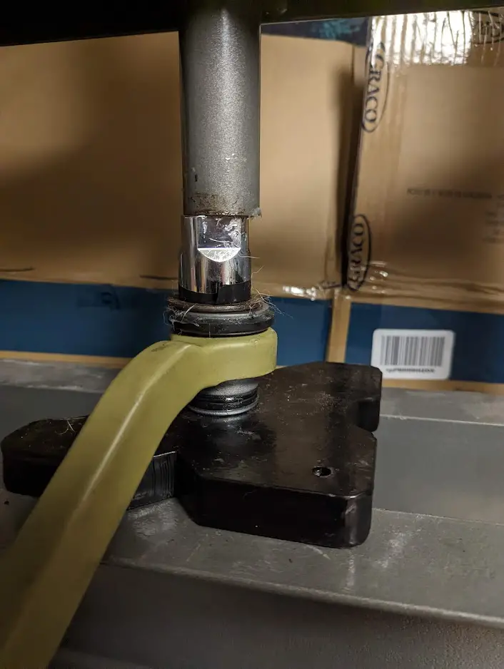

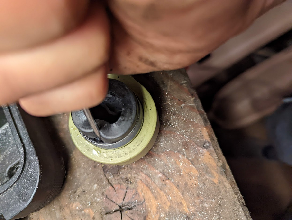

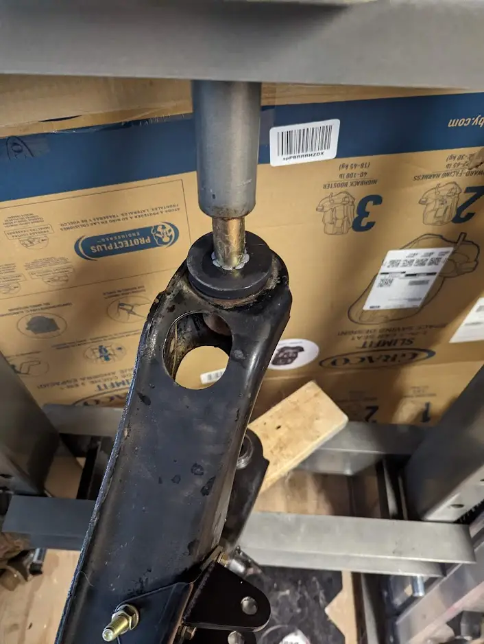

If your Ex is still riding on the original rubber bushings like mine was, they're almost certainly hardened and crusty and probably annoyingly squeaky too. I've used stop-leak to soften and swell old rubber bushings for a temporary improvement, but ultimately the best upgrade is replacing with polyurethane bushings.
!!!Warning!!! Removing lower control arms requires relieving torsion from the torsion bars -- I won't detail the procedure here but you'll need a set of jack stands to safely support the vehicle and a jack to carefully lift the torsion key so you can fully remove the adjuster screw and the part it threads into. Removing wheels, rotors, hubs, and steering knuckles will take some weight out of the system and make messing with the torsion bar easier. You have to remove all of those to get the LCA free anyway, and the shock and tie rod end too. Once everything attached to the LCA is detached and the torsion bar is pulled out, undo the two bolts through the LCA and pull it out. Then the fun begins!
