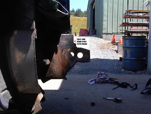

I chucked that piece I cut, in the scrap bin.
Then I cut along the top of the frame like so:
I heated up the the part that was left after those second cuts and bent it straight up to begin building up the upper mounting point.

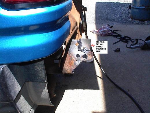

I saved the piece left after I cut and shaped it a bit on the stationary grinder then welded it into the space in the frame. Gotta totally disconnect your battery if you weld on the frame! It has been over 5 years since I`ve picked up a welder, but I just perservered. After shot is here:
( You can see, I drilled a hole where the upper mount was going to be, just so I knew how much, or if, I needed to weld some metal on.)

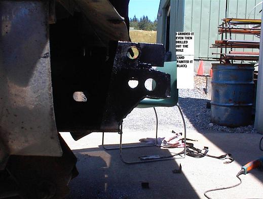

Then I did the other side, and drilled out the holes. I purposely drilled them a little bigger in case I needed some fine tuning or they were a little off frome each other.
Then I evened up & cleaned everything up with the hand grinder and buffer, then threw some black paint on the whole back frame:

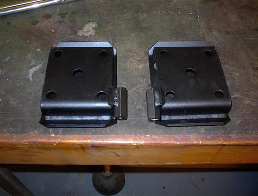

WAR 153 shackles and WAR 1780 skidplates
Okay I wanted to raise the rear a bit to get a little rake happenin`.
The truck seemed to ride a little low in the rear, especially if I had a lot of weight in the back.
I was happy to see that Warrior makes shock mount skidplates for us now, so I got a set of those too.
It was an easy install, using techniques I`ve already mentioned, so I won`t bore ya!
Heres some pics:

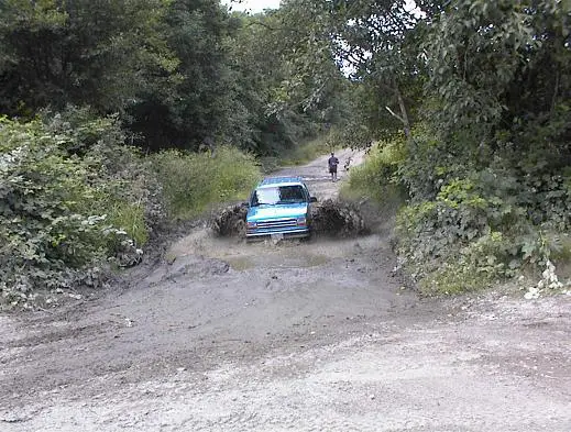

A few days after installation, I was feeling antsy, so I got my couzin to show me these wheeling pits out in Surrey BC.
I had my first chance to use my tow hooks there! My cuz went carreening into a mud pit and "KATCHANG" toasts his front axle. Then he couldn`t get out. Itwas rather comical, and I grabbed my camera for kind of a cool shot.
Chuckle. I like how you can see in the pic that his front tires aren`t spinning. Doh!

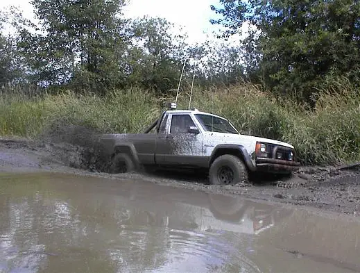

At this point I was asked by crankcase in my last thread weather I was in those mudpits. Well I took it easy but:
