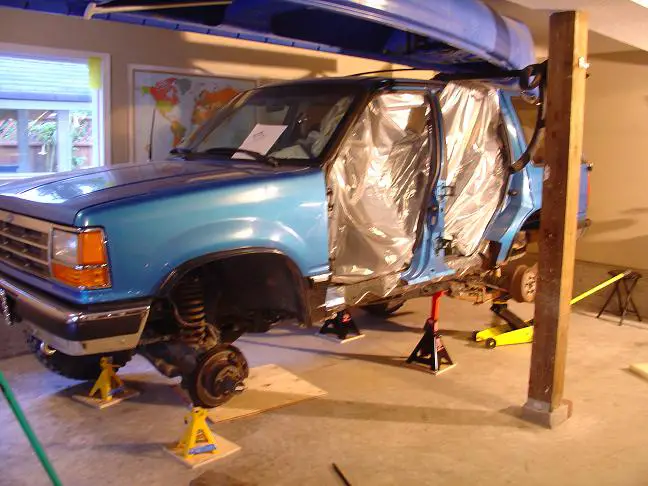

This weekend I sandblasted the 9 inch and welded the spring perches on, also I cut the shock mounts off since they would be unusable now. I also did a light sandblast on my Old Man Emu springs, washed them and rinsed with cold water to start a sheen of rust, brushed "rust converter" on them, primed them and am doing a top coat tonight. Also had time to finish cutting out all the rust on the driver`s side rockers, do a little rust work and start the fitment of the replacement metal. I sprayed with weld thru primer in the meantime.
Would have dropped the gas tank but a friend dropped by and insisted we drink rum down at the river..
The D44 is in pieces. But since the rear should be easier I chose to do that first.

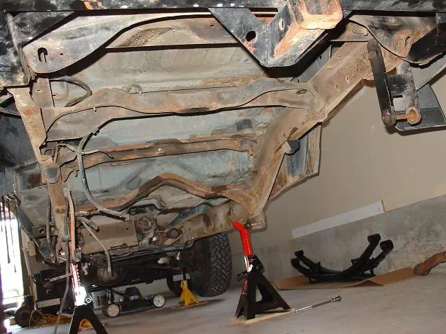

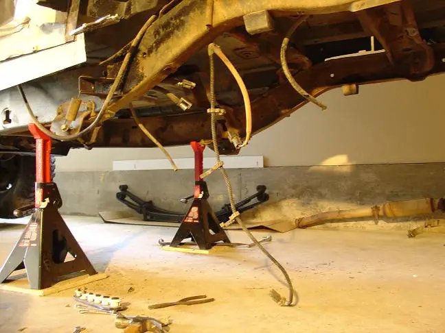

Got the underside from t-case back all gutted and ready for attacking rust. I was wondering what the wire was going to my 8.8. Anyone know?

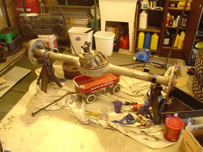

Here`s a pic of my 9 inch with perches moved in.
The stock width on the 9 inch axle from center of perch to center of perch was 44 inches. The Explorer is 39 inches. I did some math so that`s 2.5 inches a side. I did them dead even with the old perch angle, I hope that`s the right way to do it...
