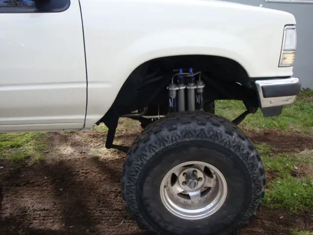

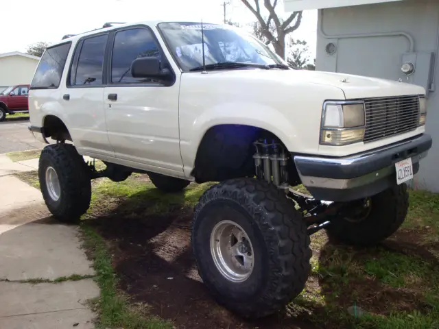

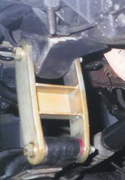

Definately put your shackles in the rear, Like they are supposed to be....
