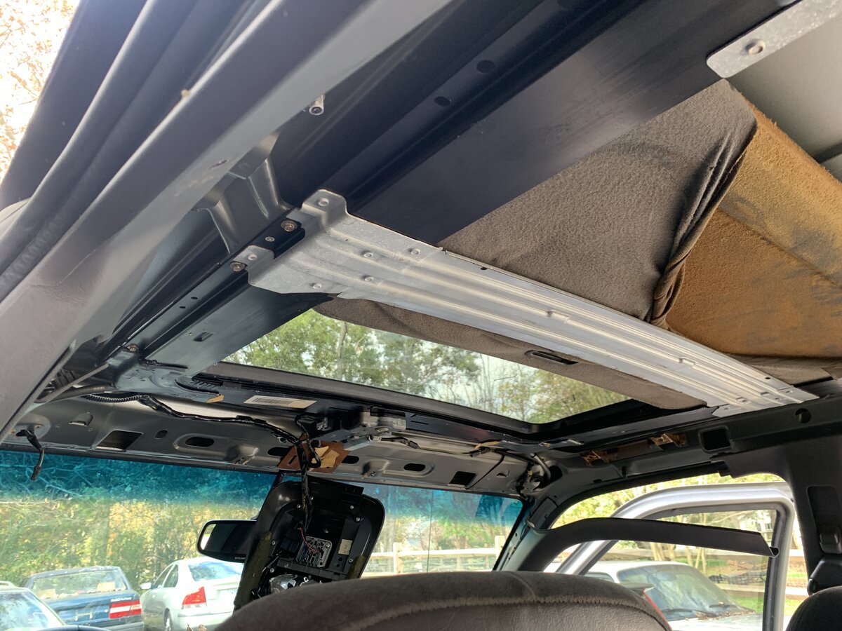

I just dropped my headliner last weekend to look into a similar issue. The rear corners of my headliner around the sunroof were getting wet, and water was streaming down the left cargo area window. When I dropped the headliner, to my surprise, the sunroof drain tubes were all connected. The fronts were more secure than the rears, but I pulled them all, cleaned them with a pick and compressed air, then reattached using ear-type (Oetiker) hose clamps.

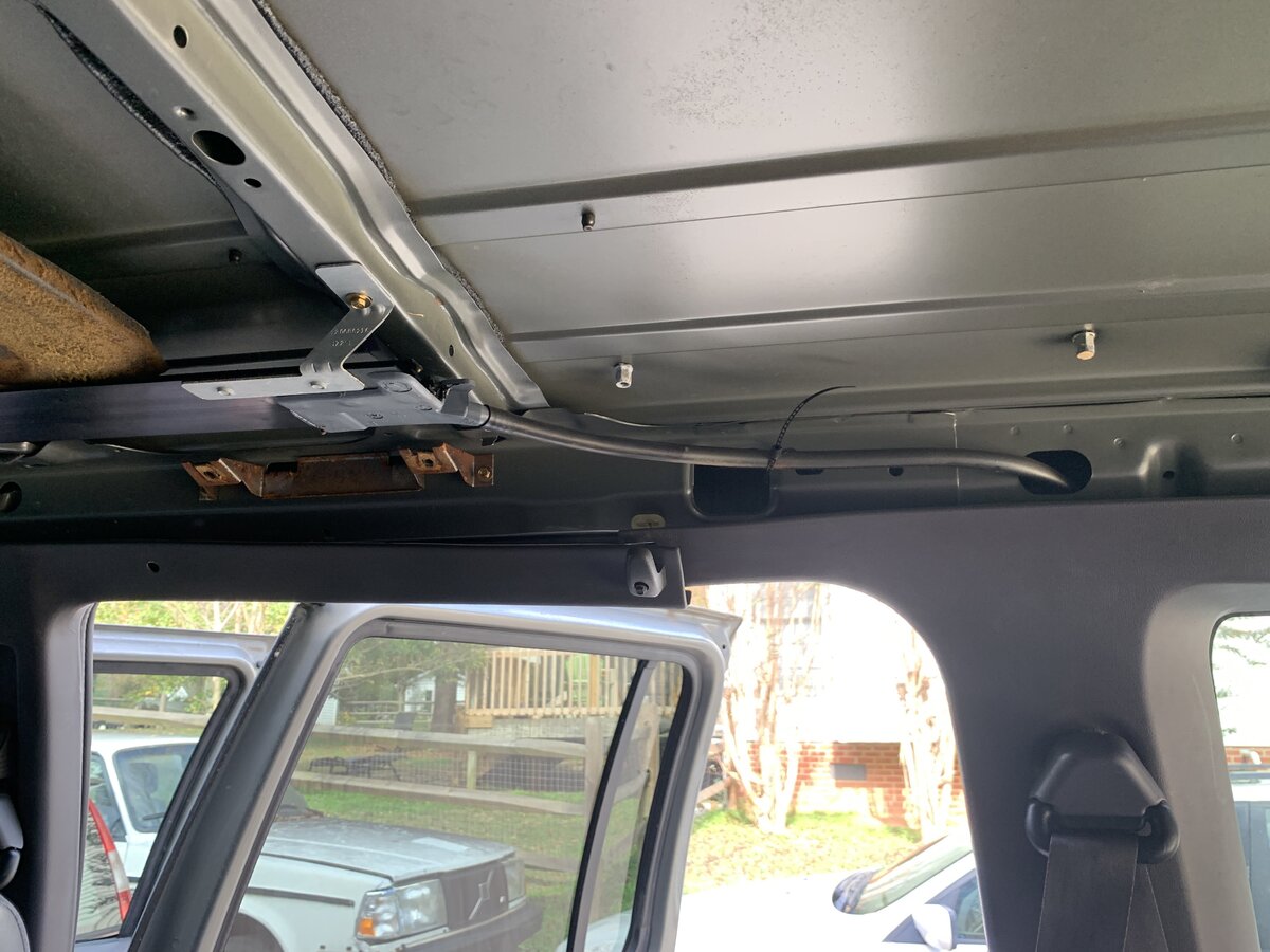

That cracking on the hose is just the paint, the rubber itself is in good shape.

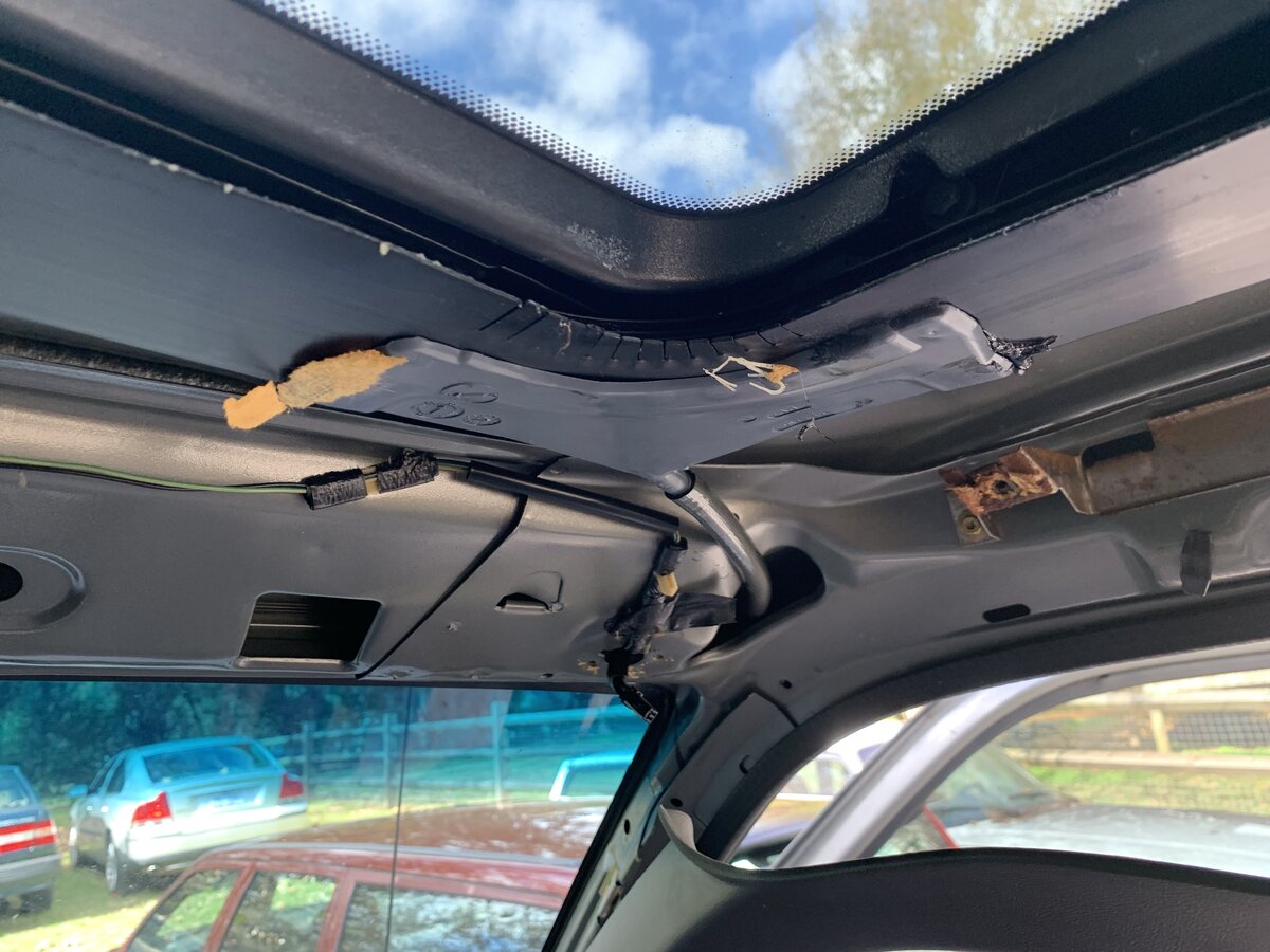

Here are more pics of how mine is set up. There are these plastic corner "gutters" where the hoses connect.

Does your sunroof have a large piece of sheetmetal covering the slide? I was able to fix the hose, but I'm still leaking from one of the wells in the back that drain the tracks. Water seems to be coming out of that piece of sheetmetal, around the well area. You just have a simple bracket there. I know 98+ they did everything to lighten up the top. Even made the roof more crush prone to reduce weight.
Not clear yet how things are attached. Prob going to have to drop the sunroof. Hopefully it can be siliconed.
All my drains have a short tube then a 1/2" to 3/8" barbed adapter. I had to get a replacement because it broke when I tried to get one tube off. Those are not easy to find! O'reilly had it.

I have a full heavy cover over the rear. If the slider is pushed back, I don't see it. I will try to get a pic. Could be a different part, for the older ones.
This is for an Expedition, but there are leak points on the sunroof.
Oh wow, yeah that's a much larger shield. Ford must have changed that somewhere between late '99 and '01.
