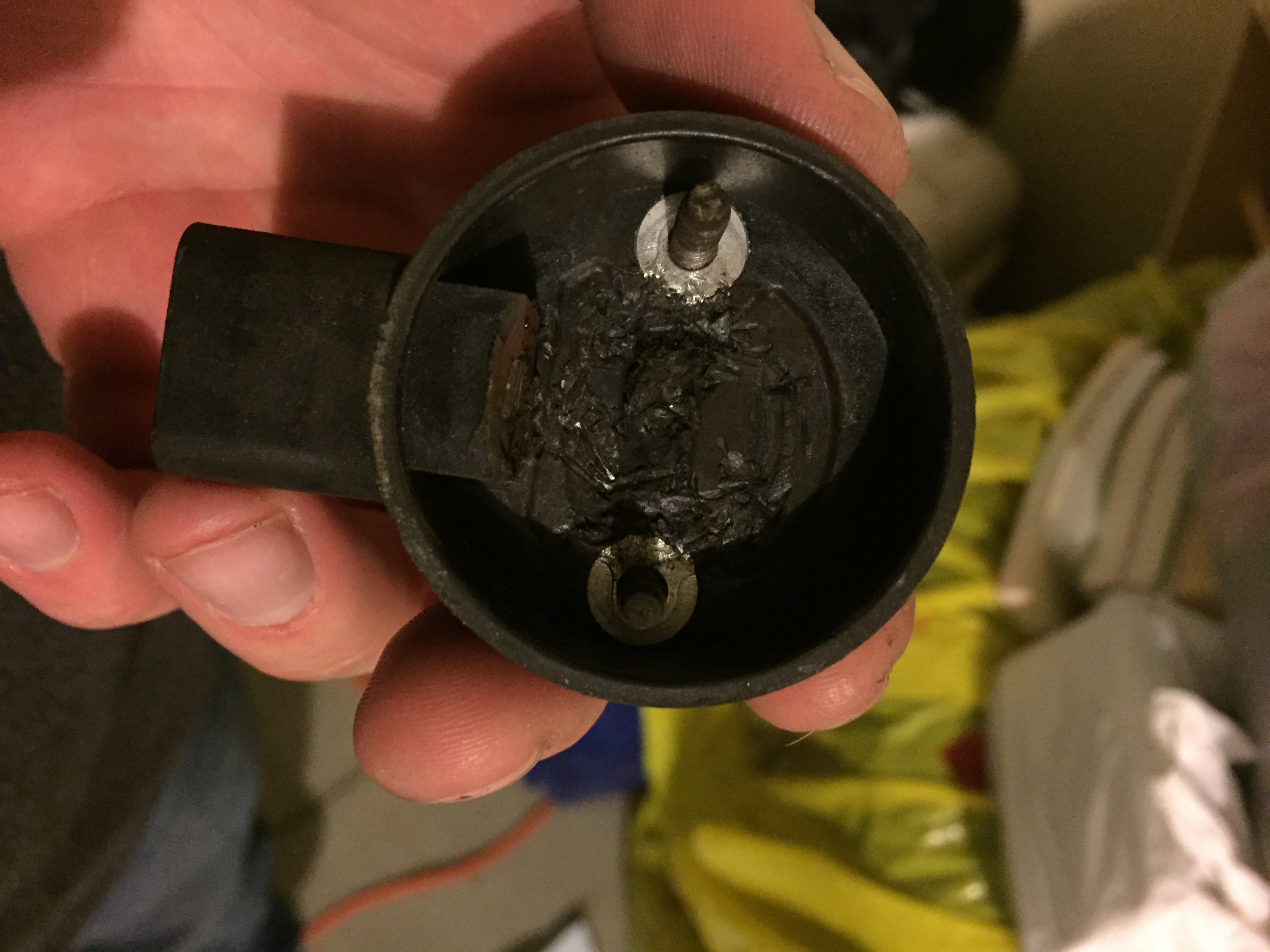

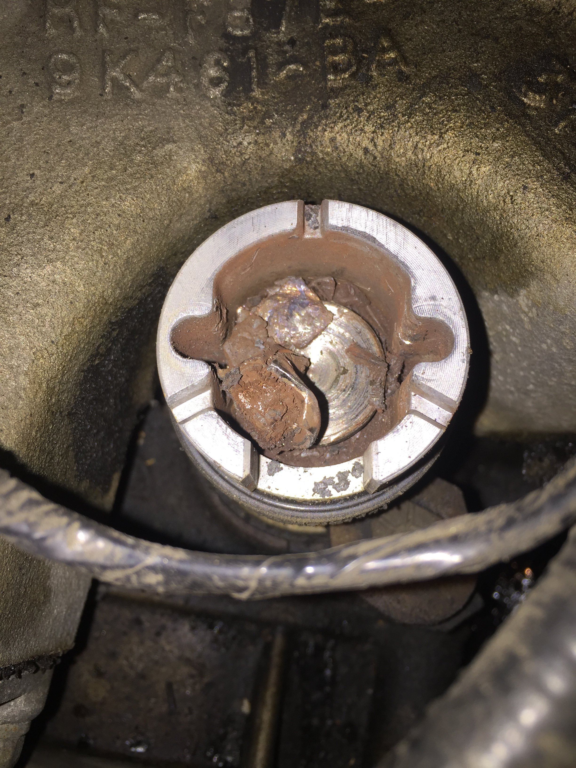

the plot thickens! I got a little more time last night to play around with my project (97 5.0 AWD). My new scanner arrived in the mail yesterday and I gave it a test run with the ignition on but engine off. It gave me the DTC P0340 which is the cam shaft position sensor or circuit malfunction. I also read a "Permanent DTC" that I was unable to read, I'm not sure if that's because the engine was off or because the scanner can't read those codes from this car. My EGR tube is nearly broken in half and I'm pretty sure RH side header is cracked too. I'm hoping that once I repair those things the permanent dtc code will clear or at least the car will be mobile enough ill be able to hook it up to a better quality scanner and see if it'll give me the code.
I've got a pretty significant coolant leak and I believe it's the water pump/ gasket that has failed. Isn't the CPS and water pump right near each other? I wonder if the sensor or electrical connector got soaked in coolant. Looks like there's some good videos on YouTube and a few right ups about the pump and the CPS. I'm a little apprehensive about changing the water pump because of the issues with the bolts and studs. I'll be buying a stud extractor before I start this project. Anyone else here throw the P0340 code, was it the sensor that failed or was it something in the circuit?
