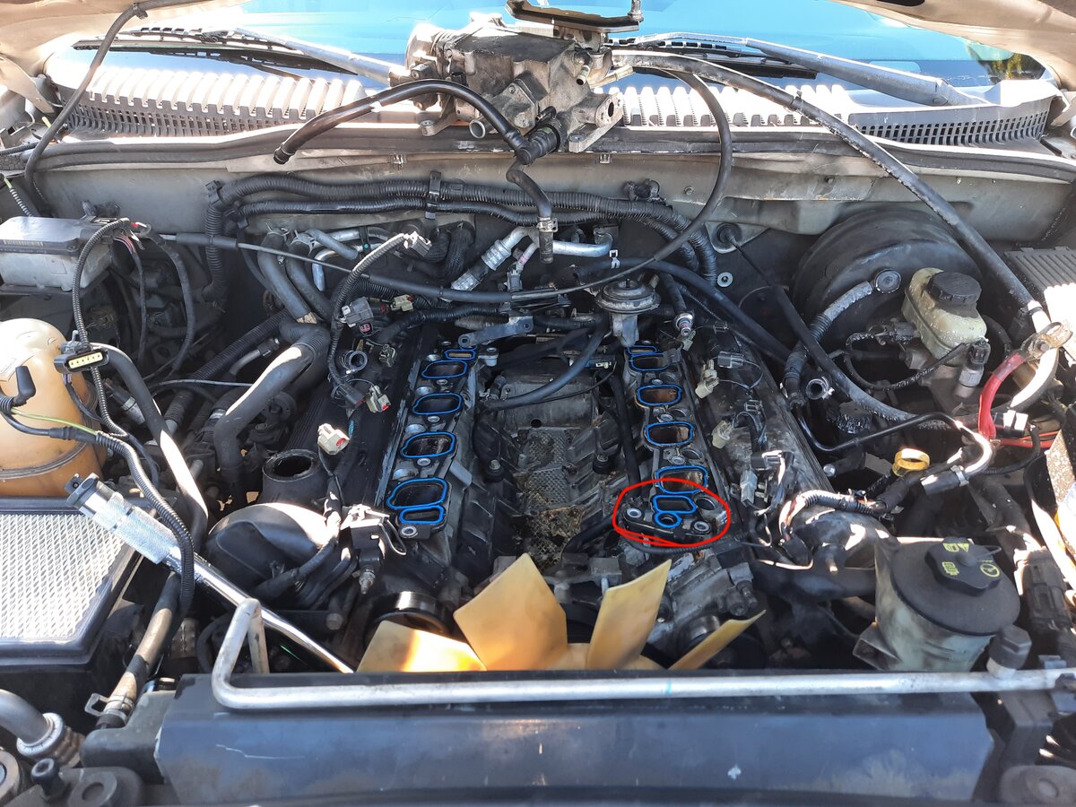

I recently turned 18 and purchased my explorer for a really good price, only problem I noticed at the time was a faulty alternator, I replaced that along with spark plugs. Soon after, I discovered a coolant leak. Took me a good while to discover exactly what and where it is. I bought a new intake manifold and swapped it out. Fixed the leak. After that, I've been getting lean codes on a small scanner I bought. I lived with it for a while while trying to figure it out. I had a coolant hose pop off at one point, I put it back on and put a hose clamp on it instead. The rebuilt alternator failed so then I but a new one instead and put it in. I blew smoke through the vacuum system and saw smoke coming out between the egr and throttle body. I bought a metal gasket, but it didn't solve any codes. I decided to just go for it and swap the oxygen sensors. Was a hassle but I got at 4 swapped out for new ones. Sadly, not a thing changed. Also swapped the brake pads. The car drives, symptoms are horrible gas mileage, rough idle after 5 minutes warming up, and only recently, the car jerks back and forth as if the throttle was being tapped, rarely when holding a medium speed.

If it started immediately after the intake swap it could be a bad gasket or it’s improperly seated.

I'll pickup some cleaner for sure! How should I go about cleaning the tubes? I did take a look at the MAF sensor and it looked pretty good. When I did the intake swap, the intake came with pre installed gaskets in the actual intake, but I bought the full gaskets and put the on anyway. I went back in a bit later and took em out to see if they were actually causing problem, but nothing changed when I did.

I wasn’t clear on the tubes, don’t clean them, I was suggesting you check for cracks in the rubber that might open up and allow air in under vacuum but didn’t show up in your smoke test.
As long as you didn’t double up the gaskets and the ones you used mated with the manifold properly. I haven’t replaced an intake manifold on the ex before so I don’t have any other suggestions there. But looks like I might be doing that soon to solve my coolant leak. Thanks for the picture.

So after a long time of figuring it out, I finally got my service engine light to stay dormant. I went to a junkyard and picked up a wiring harness and an original intake manifold. The wiring harness just had one incompatibility which was the egr sensor so I went to AutoZone and pick up one that would be the right socket for the harness. The OEM manifold I got wasn't cracked but it looks like it had maintenance to prevent it from happening. Put it all together and have never had a problem since. Also cut a hole in the floor to replace the fuel pump and everything feels in pretty good order! Thankyou to all that helped me with this process! Hope this can help some in the future.
