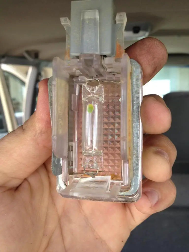

I just ordered a set of the led bulbs on ebay to replace my map, dome, puddle, and licensce plate lights. My question is what bulb do i use for the cargo light in the rear. I took it out and its not a 194. Its basically a cylinder with two u type hooks on each end. I thought it was a sestoon bulb but they dont have hooks on the end just basically metal ends. Does anyone know what led bulb i can get for this light?

This is the bulb that is is in cargo area it looks similar but it has those u hooks instaed of the pointed ends. Do you think it will still work?

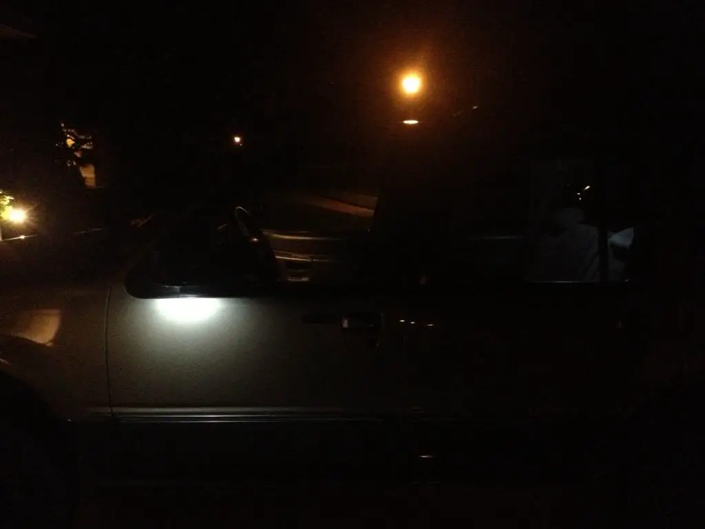

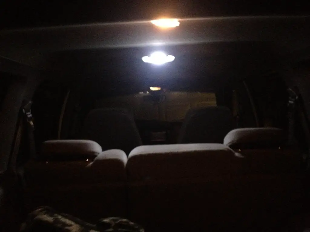

These are the lights so far on where i got them installed
Puddle light
Licensce Plate lights (Blurry but you can still tell brightness)
Dome light (Didnt get MAP or cargo lights installed, helps tell the difference)

With the Cargo light the only option is to make your own. I searched for a while and couldn't find anything remotely close.

Actually, I assume the one with pointed ends should work, so long as you find a way to make it stay in the slot. Probably a little glue or tape to hold it in.

Here's what I did.
Soldered in a festoon and it works great.

I may have found on that works. My Firebird has the same type of bulb in the overhead lamp as found in the cargo area, but the firebird bulb when I did a search on superbright's website, came up with a festoon that had hooks. The bulbs look like they're the same length so I ordered 2. I will tell you all how it fits when I get it later this week.
Here is the link to it:
Firebird dome light
edit:
If you look at the length, it's identical so it should work. I'll let you all know when I get it.

Hmm, looks like it should work.
Mine has held up great though, so no complaints. :)

Got mine on CARID.com. Festoon style is correct, and mine was able to simply "plug in" between the two metal clip ends to stay put. Looks great. No need to do any wiring.

I like the soldered conversion DJ, because of first, the loop type I purchased did not fit well, not at all without reshaping the loops. And a second it has to be slapped to turn on, the connection is that bad. The solder looks good, I'm going to solder mine and see if it will stop flickering. If not I'll just stick on a 48LED panel I have on hand.
