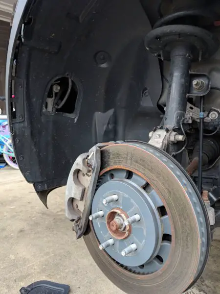

Ok, perhaps this doesn't apply because I have a 2017 that has the LED fogs already installed. However, when I briefly looked at mine to try to offer some help I noticed there is an access hatch directly behind the fog lamps in the inner fender well that appears to be to for access to change the bulbs. It's certainly not big enough to change the entire light assembly (I imagine you'd have to take out the inner fender well to do that), but I can't imagine they'd put that access hatch there if you couldn't change the bulb.
You might want to take a look and see if you have the same access hatch in your fender well. If so I would imagine you could just do a quick bulb swap.

There is a little door/hatch on the front of the splash shield in the wheel well. It opens, you reach your hand in, and remove the old halogen bulb. Pop in the new LED bulb, and reinstall the door/hatch. 5 minute job. I did not have to replace the whole thing.
And as I shared earlier in the thread here's what the hatch looks like so you know what you're looking for. :)

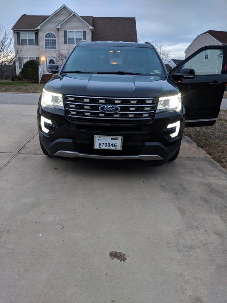

Found these LED lights at AutoZone for $140. Looked awful with yellow halogens, plus no fog in my area.
The color is an exact match, and not too bright either.
FYI you have to plug the electrical connector in backwards. The tab will be on the back of the connection. Took all of 15 minutes
