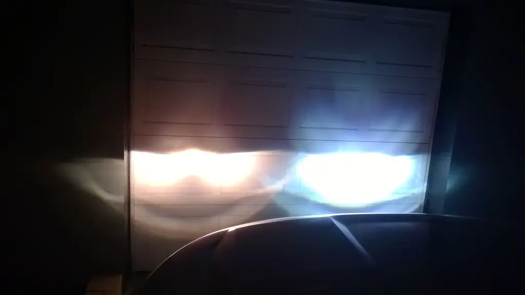

I have these and they are awesome! All plug and play, very bright.
http://www.ebay.com/itm/161642725572
Here is a side by side comparison of the stock bulb on the left and the Philips LED on the right:

be interesting to see down the road vs. 3 feet from the door.

Definitely a very bright light. Looking at the picture, my only concern would be as to what is causing that 'splash' of light that looks a bit like a maple leaf above the horizontal cut-off. Hopefully it is just the garage door reflecting the light.

The light off these bulbs is great while driving. Signs reflect brighter and from further away as well as the lines on the road. The shape you see above the cutoff line is just from the garage door. I've never had anyone flash me or complain when we follow friends.
