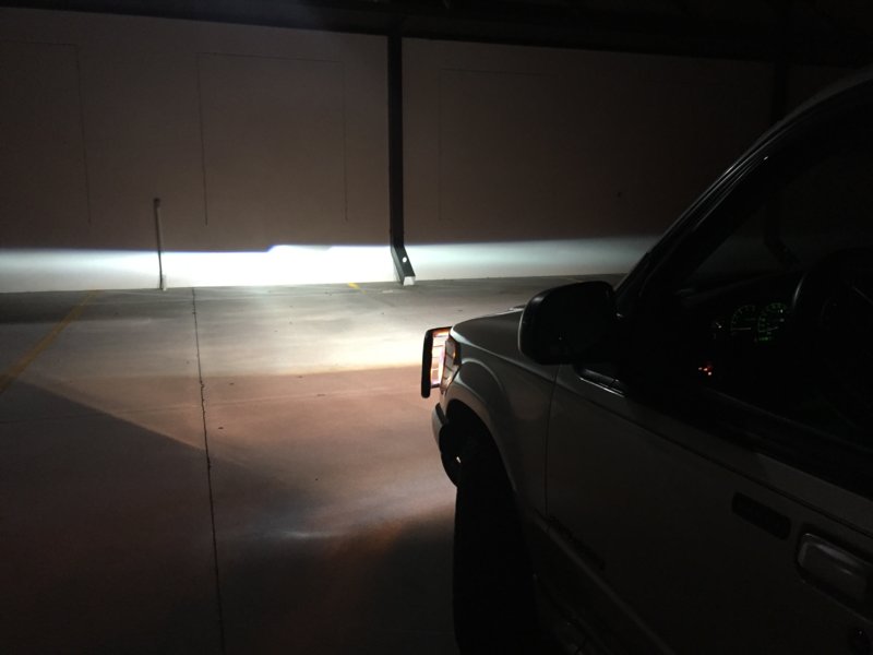

That’s where I bought my Stage III kit from. I’ve also purchased switchback drl’s and xb led fog light assemblies from them too.

Sticking gimmick HID bulbs in a projector housing designed for halogen bulbs gives the illusion of being "awesome" because projectors have a sharper cutoff than regular reflector housings (especially those with fluted lenses). While they might be slightly less terrible, they are still poor compared to sticking the proper bulb into the proper housing designed for it.
The thing really worth noting is that it is against the law to put on an HID kit and stick HID bulbs into a housing that is designed for halogen bulbs.
