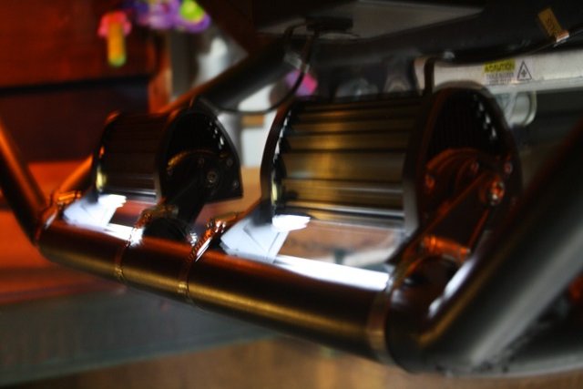

new LED's mounted off the top bar of the bumper, but sit behind tube for protection.

The easiest mounting would be from the top bar. Few hose clamps and I'm done.
Top bar looks better IMHO.
:bsnicker: put them right under where the old ones were, so they look like buck teeth
The lower mounting looks better to me, plus seems like more secure mounting to the bumper, and could even have a piece of flat bar around the top and sides for extra protection and security. Only downside might be less throw than a higher mount and any interference with the winch - or a risk of damaging the lamps when winching.
Top bar mounting seems like it'd be better for high speed baja blasting or race driving/prerunning since you'd get more beam distance from the height, but the big risk to me, especially just using hose clamps, is theft. If you decide to mount them up there, I think it'd be a good idea to make some boxes for them from flat bar and weld those to the hoop, which would give additional protection on the trail, but also give some way to bolt them on, and hopefully make it really tough to remove them quicky and easily.

I vote top. I think they look better on the bottom, BUT up top, they're behind the bar for protection.

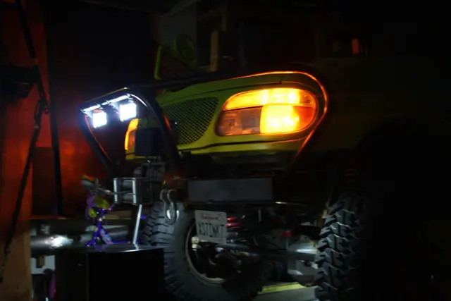

Well I got the hose clamps today from work. We carry the Stainless Steel Marine grade ones in all the sizes. Plus I get a discount:D
Just need to route the wiring, and hook them up for real;)

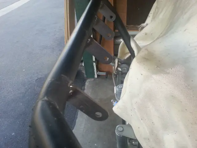

decided to make these a little more secure, So I picked up some tabs today and welded them on. ;) cut off the old tabs, and just need to wire them now.
