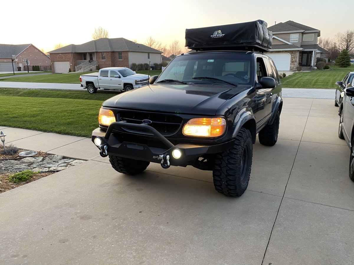

EAG bumper grafted on from a JK. Fogs are LEDs but they need to be upgraded as they are not the greatest
Added fog lights... 😊

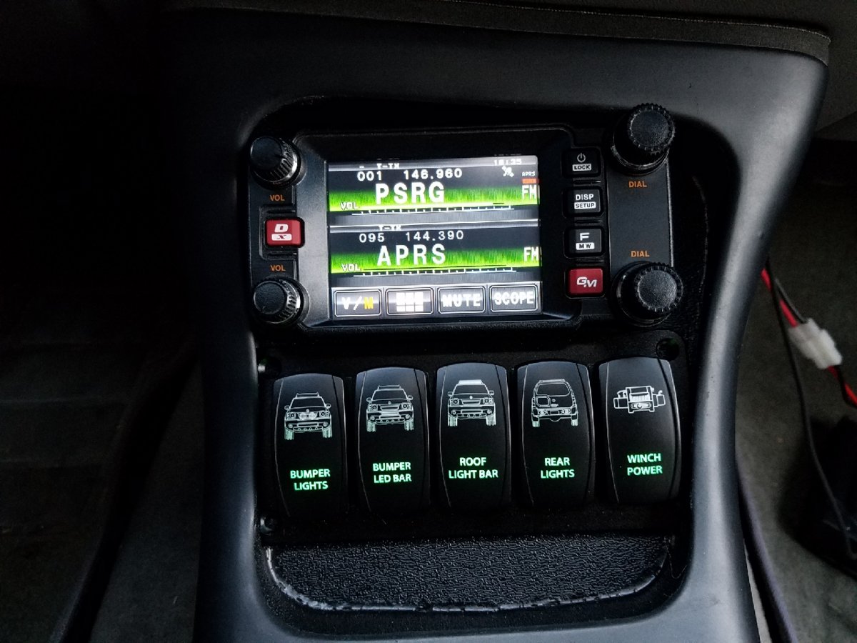

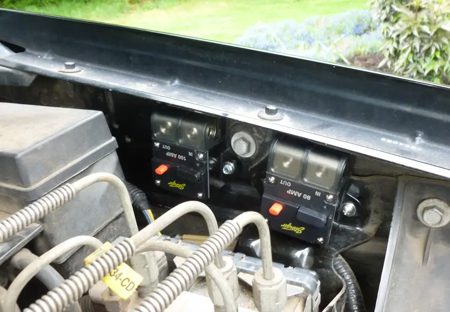

Installed the Roof bar and ditch lights on the roof rack.

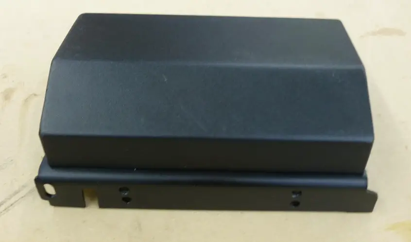

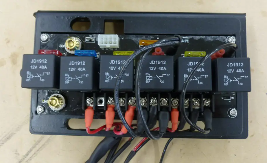

Using a relay box from a Chinese copy of the Jeep Wrangler SPOD system.
Still hooking everything up.
