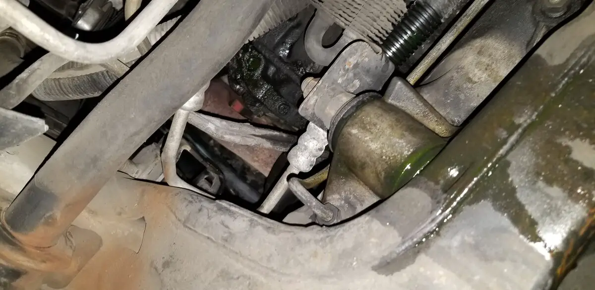

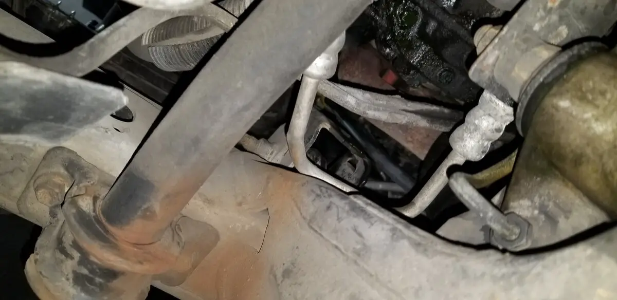

Ok guys im getting annoyed of the constant coolant refilling im doing so its time to take care of it. Problem is i dont have the right tools nor the full knowledge. But ive kept my exploder away from a mechanic since the day i got her.
Here it is. Im leaking coolant and would like an estimated guess of spots it my be coming from. Without jacking her up (im at a gas station) this is what im able to see. Any help would be very appreciated.

The coolant we can see is on the bottom left, front of the oil pan. So go upward from there, that coolant has to be from the front left side of the engine, such as the water pump. If the thermostat housing isn't showing much leakage, it's not likely from that.
With that much coolant present, it should be visible to see running down somewhere. I'd hope for the water pump, that's kind of minor versus the timing cover, on the 4.0 engines.

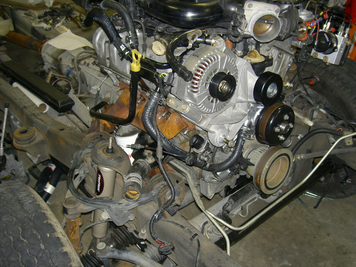

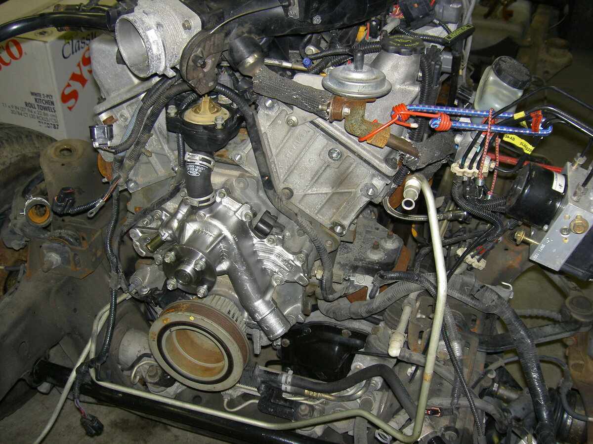

Here are two good pictures which show how the coolant hoses and heater control valve are connected at the WP and thermostat housing.

Great pictures
