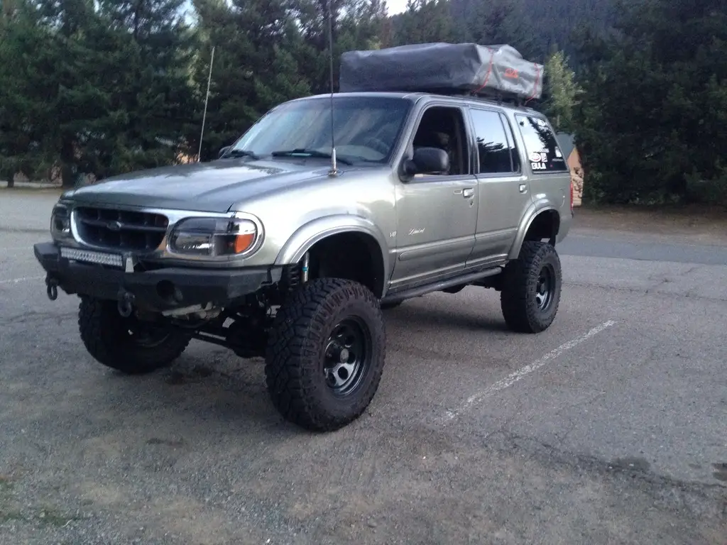

Just finished my sas and rebuilt the tranny too, might as well put her through her paces playing tow rig and camping. Haven't wheeled hard ... Yet
That SAS look pretty good. A little tough to tell with that boat trailer pushing the back end down. Looks like a 4 link set up? I just got my new springs. They are ZJ lift springs from Iron Rock Offroad. I need to cut about 2 coils out to get my desired height and spring rate. Hope to have them installed in about a week.
Nice ! Let me know how it feels when you get them in. Back end looks pretty low from the picture angle, boat and being pretty loaded, plus the tent. On level ground with no weight she is 3" shorter in the rear, once I take the sloped BL out she'll sit even and going to add 150 leafs to raise the back a couple inches for a nice rake

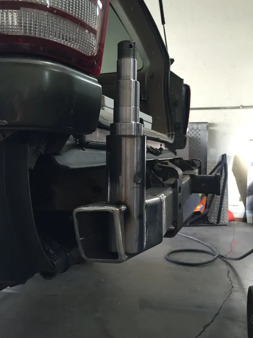

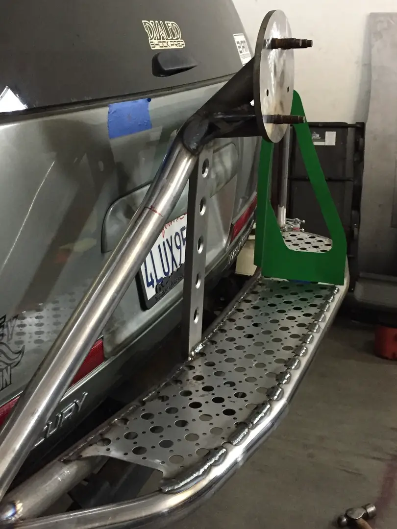

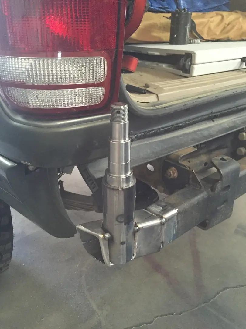

How does the swing out attach to the factory bumper? Is there more support underneath?
Ya, years ago I built a hitch hidden inside the bumper by modifying the stock bumper brackets, and I did it with a tire carrier in mind for the future, so I built off of that. Not my idea, Jefe did it first, but I put my own spin on it.
I had this idea floating around in my head for a while also. Very clean looking when it is all done. Unfortunately I discovered that I would really like to have a bit of side protection so a complete bumper is in my future.
Very nice finish indeed!

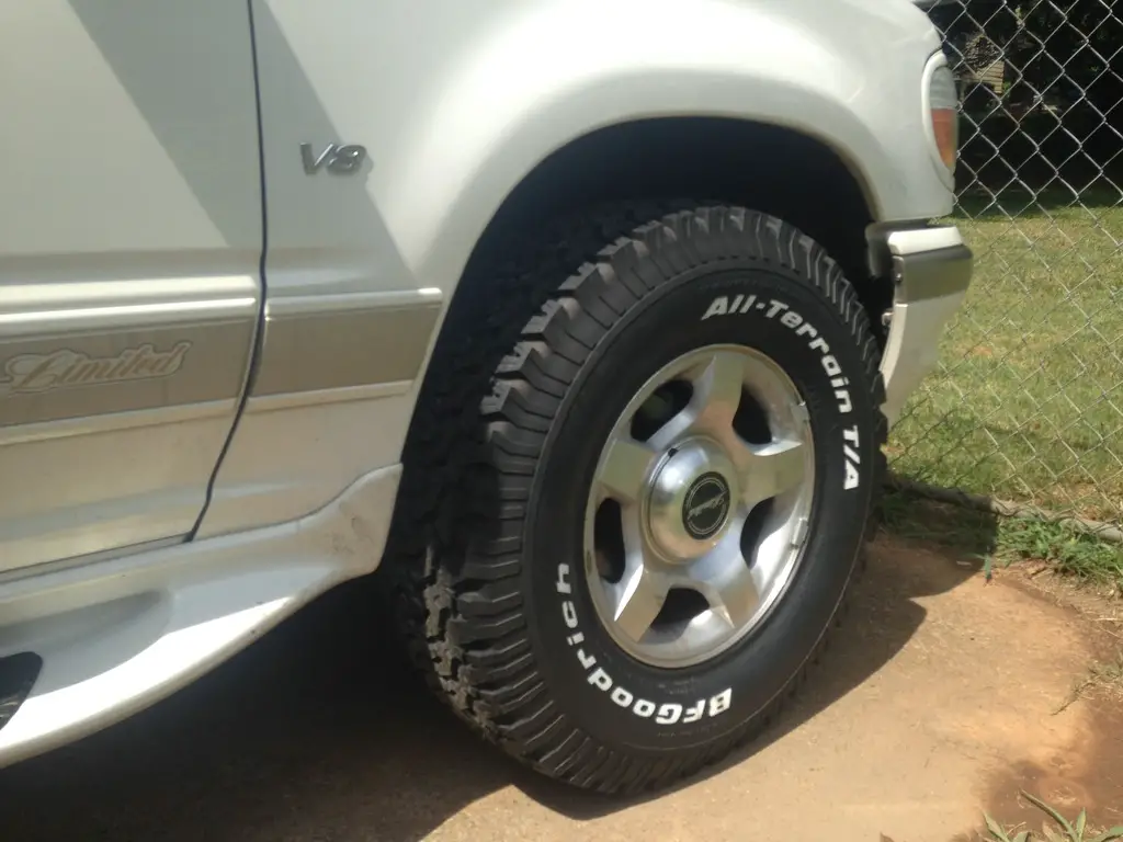

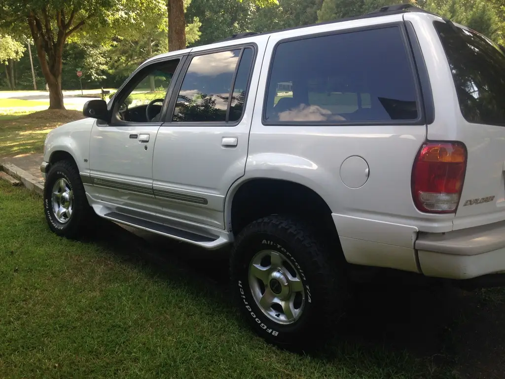

Just did a 2" TT / shackle lift. Added BFG AT 265/75/16 which are on clearance at Pep Boys for $135 a tire.
[/URLCF4AE5FC-4177-4D79-88FF-AB36DF4C2E3E_zpsife1zpln.jpg
Be careful with those wheel spacers! Looks good though.
I was, yours looks a little bit wider than normal to me so I assumed you had small ones. But no spacers, even better!
