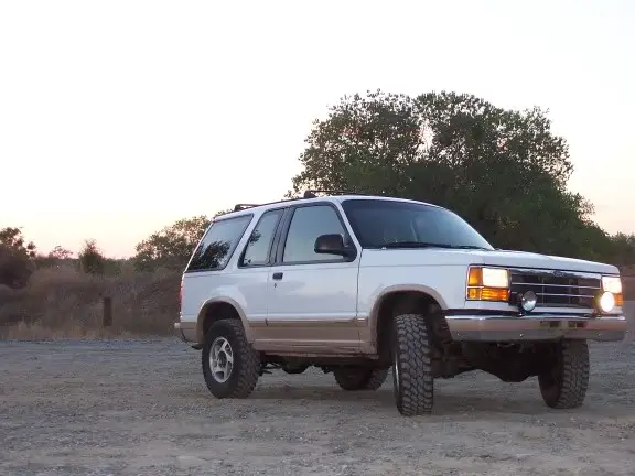

Well this is my 93 explorer. so far its only lifted 2" and 30 " mud rovers but i just orderd a set of 4.56 gears off e bay for the rear end(not sure if im going sas or not so no front gears yet) well hears some pics.

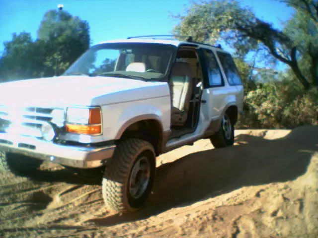

Looks good. I love the look without the doors. I can't wait til spring time! So are there just a couple of connectors in the doors that you can unplug when removing them? What did you do about the hinges? Completely unbolt them? Make a pin so it's like a Heep Wrangler? Did I mention I can't wait til spring time?
I wanna know about the doors too. Has anybody come up with an easy way to remove them when wanted?
The plugs for the doors are behind the kick panl. it's easier to unplug them befor you unbolt the doors. i left the hinge on the car for a foot rest. :D mark the door wher the hinge is befor you unbolt it and that will help you line it bake up when you put them back on. you will need a friend to help i try to do it by myself and the door fell off the jack and now ther is a big dent on the bottom of the door. :banghead:

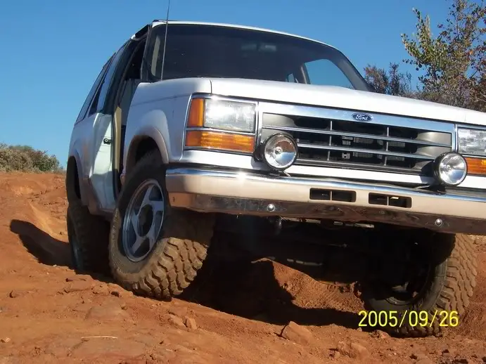

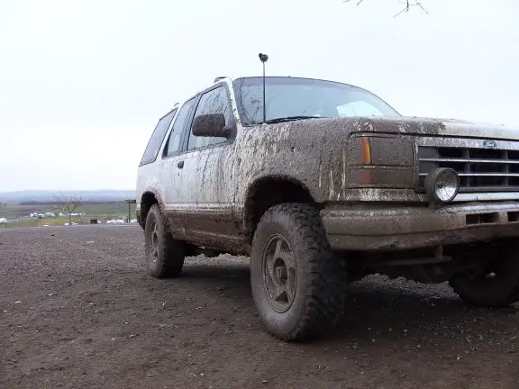

Thanks , im glad every one likes it. hear are some more pics.
This took 12 hours to get out. lol
hears some pics from today.
this was a little scary. almost put it on its side

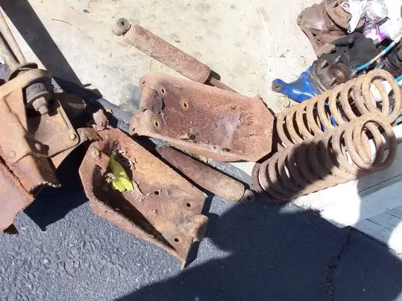

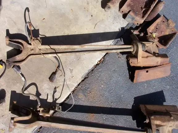

Got some new parts for my sas.
:D
I dont know if i will use the buckets or not, i will have to clean them up and see if i like them or not.
