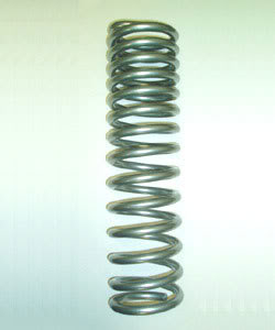

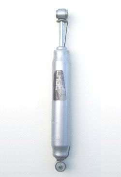

ordered my springs and shocks today so hopefully they will be hear by the weekend. :)
i am going with the cage 5.5 springs and there 14" travle shocks

springs and shocks came today :)
