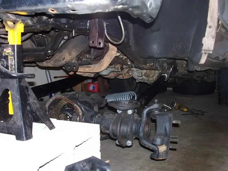

OK well my buddy is stopping bye tomorrow to pic up the 3rd member :):thumbsup: and i finally got some pics lol
seen this before.
and i need some new jack stands thes are in the way now. :rolleyes:
I would do something about that track bar bracket. Those welds don't look very good and the frame on Ex's and Rangers has been know to tear in that area. I would cut the bracket off, then weld it securely to a plate and bolt it back on using the bolts from the steering box. You could also plate that area and then weld the bracket back on.

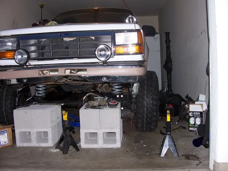

OK i got the cols compressed and trying to mock up the towers. found out the cage coils are about 20" tall with the weight of the ex on them. so im thinkin of using the whole tower. think thet will be tall enough for 35?i also drilled to hools in the lower spring retainers 2" in, and im going to weld a gusset from the retainer to the ra cap so it will be one piece. and i think ima cut the bucket to fit around the bump in the frame. sound good? leme know your thaghts on this. thanks

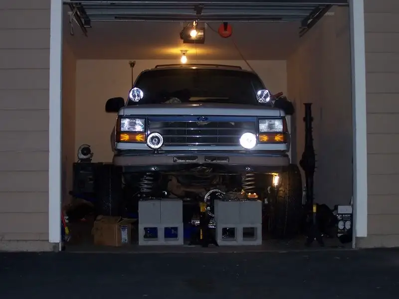

ok got the driver side coil bucket half way mounted but it looks like it will fit nicely :) i still need to weld along all the edges, but i will hopefully get that dun tonight. what do you guy think?
well it seems my measurement of the coils was wrong. seams they sit the same as the wild horses springs. so the truck sits just about where it was before, just a whole lot wider :) lol. the drive bucket is almost dun but still need to finish weld it. i will be going to pic n pull on Sunday for some steering parts :). then hopefully i can drive it till i get the 3rd for the 9" back then i will put that in :)
looks good. I like the idea of not spacing out the coil buckets and moving the lower coil mounts in two inches instead. Can you show a picture of the lower mount with the gusset you made. I might try it this way with my SAS.
