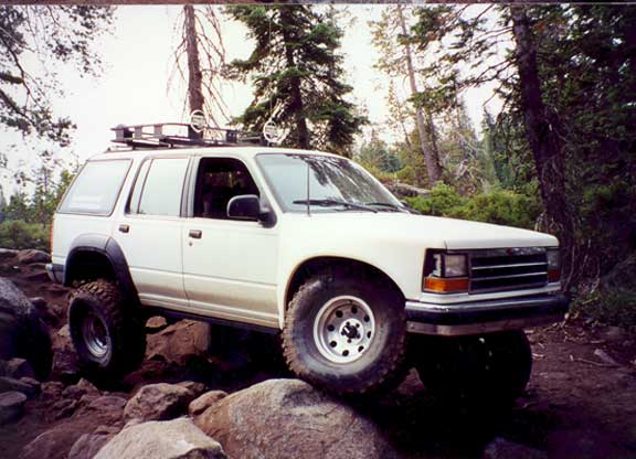

You can fit 33s with that lift. Here is my old '92 with 4" TrailMaster and 33 ATs

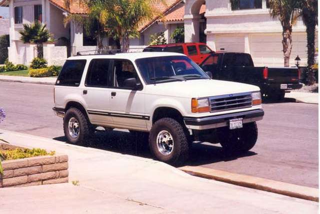

here it is with glass up front:

Anyway, yes they were 33x12.5 on 15x8 wheels with 3.75 backspacing. I didn't rub at all, but you can assure that you won't rub, by hammering back that pinch weld on the firewall.
The second set of pics are with the same lift and 35s.
