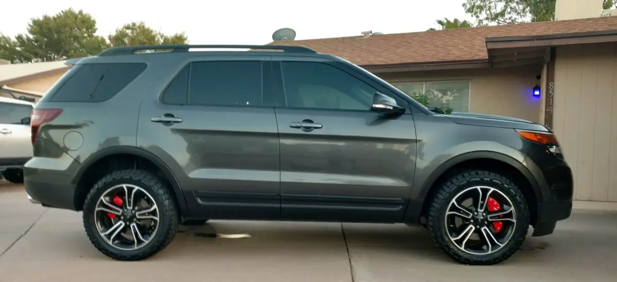

Here ya go, a before and after. I showed the lift job to the owner of Truxxx who I've become somewhat friends with now and he didn't like how low it still was in the front. Says it's due to the springs they used in this particular truck as Ford uses different kinda springs in some model Sports. He says this one obviously has the softer springs so he is fabbing me up a set of 1/8" plates to add in that will make up the difference. I would definitely go with the Truxxx brand because the product is solid, they use VERY simple directions that are easy to follow even if you have no idea what you're doing, and the customer service is absolutely phenomenal. They're always ready to help in any way they can.
As far as stuffing 33's in there...sorry bro and don't take this personal but you'd be stupid to. Especially if you plan on doing actual offroading. I added a third pic to show just how close these tires are to rubbing the front of the rear wheel well. Even if you mod that area, it's still cutting it extremely close. I'll never understand, other than for aesthetics, why people feel they need to cram as much rubber in there as they can. In reality, especially with SUV's and other vehicles with smaller wheel wells, more is not always better when offroading. In fact, sometimes you may even want to go about 1.25" smaller than factory because when offroading, you want that wheel and tire to have room to move around instead of constantly rubbing every bump. Just because that 33 fits while sitting in your driveway or going down smooth roads, doesn't mean it's going to be a good fit when on the bumpy trails.

What size are and brand are those tires?
Looking at the picture, they seem to be 265/50R20. Also found his other post confirming they are Nitto Ridge Grappler.

Thanks, i'm getting a 2.5" Truxxx lift kit installed in a week or so, I'll run my tires until I need new ones. Those seem to fit on the 20" rims as is and look good. I've also seen that 2016 Ford Explorer Sport done up for SEMA that has ADV.1 Wheels ADV10R (20” x 11”) Tires: Toyo A/T II 305/50R20 tires that fit on the same lift. I'm guessing a tire that big and wide might look good parked but rub a bit.
