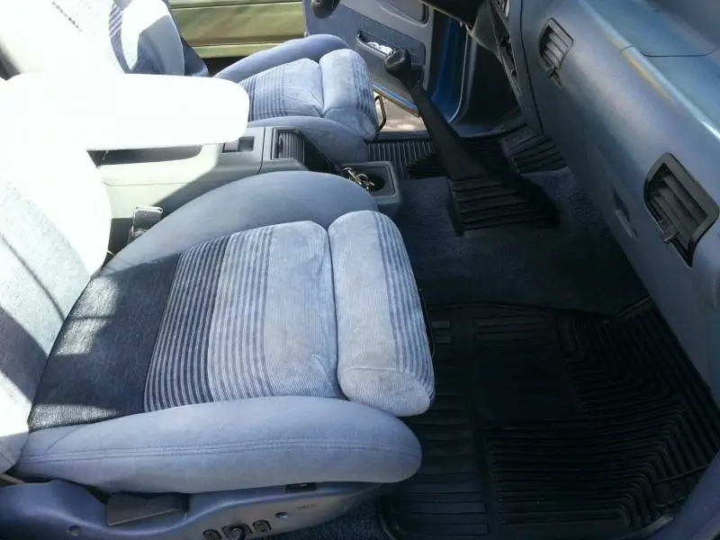

So, we just picked up a super clean, lower mileage '92 with a factory 5spd, never been in 4 wheel drive, CA only, and I believe it, clean interior, and had only a bad heater core, whinney PS pump, missing subwoofer and a small rear main leak, along with the infamous clear coat coming off. Either way, we were tired of having the weaker A4LD, so this time we did it right and got the M50D! Yay!
