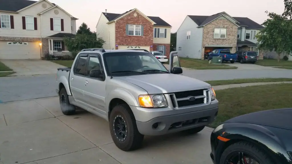

Beyond stoked that i can finally post my trac on here. Its been a long time coming but here she is...another trac on 35s:
Lets see if i can get some of the mods together:
It has a 3"BL+Prothane Body Bushings, 2"TT with AAL in rear pushing 315/75R16 BFG KO2s (very minimal trimming to fit which positively surprised me)
I upgraded the front suspension with new lower moog ball joints, upper control arms + Balljoints from moog and new tie rod ends and sway bar links but i tossed the bushings of the moog links and replaced with prothane ones. To top of the suspension i got custom shocks made for the trac by ICON vehicle dynamics.
To squeeze some extra performance out of the 4L i installed JBA shorty headers and a Magnaflow Catback along with a X4 Tuner with three custom performance tunes. The tuner also aloud me to adjust the tire revs to get the tranny and speedo back in line after the 35s went on. Tires are hauled to a stop by EBC drilled and slotted rotors with high performance brake pads. I also threw on Anzos Black hawk head lamps along with a 55w HID conversion, a 20" 200W Light bar behind the grill and 2x 40W Flood Pods instead of the fog lights.
Im sure i missed something but thats definitely the majority of mods right there! A couple cosmetic things i am not entirely happy with atm such as the grey trim (will get painted asap) and the front bumper. Im going to get a custom one made but that will be a little further down the road.
