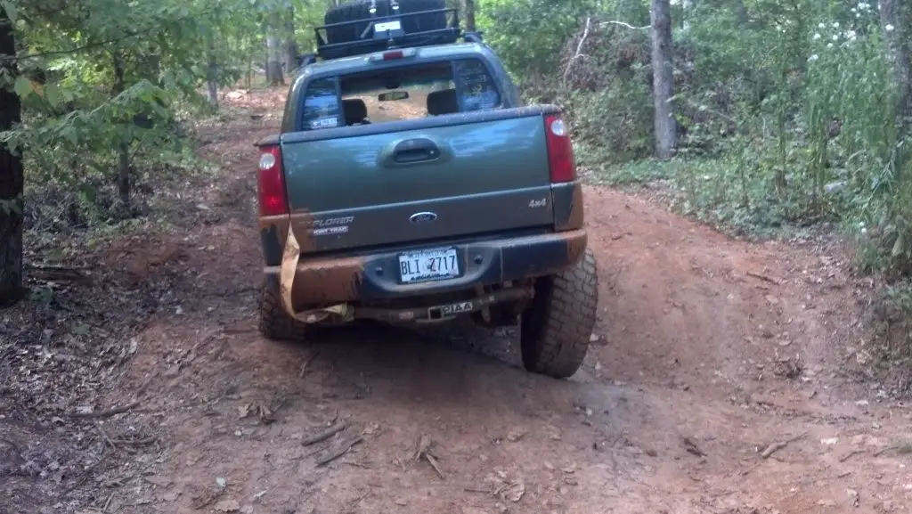

Since this is still a picture thread: :D
They are certainly more stiff but gave the squishy rear end the solid feel I wanted. The RS5000 shocks are a part of that, also. Although more stiff, they still get the movement I need:
I won't elaborate any more on why I prefer them over shackles as that has been beat to death and there's lots of opinions and you obviously already found some through the search. If nothing else, I think the AAL looks better than the shackles hanging down.
