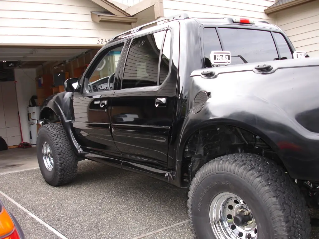

Major upgrades this past weekend, which has made my toy truck into a big boy truck. To date here are my mods - best one so far is the new shocks. Took the truck to the beach, and it was a BEAST! 33x12.5x15 on a 8" wheel with 4" backspacing. KM2 Tires. 3" body lift, 1.25" TT to level it out. (top of wheel wells are all at 40" tall) BL/TT/Tires gave me a 6.5" lift from stock. Rancho 5000's (Best mod to date). Custom Decal. Double Din DVD/GPS touchscreen system with rear view camera. Kicker Sub / amp system. 20% tint up front to match rears. Truck is very fun to drive now.

gbeal how do you like those km2's?
KM2's are really great - so far on the highway they aren't that loud - I was able to have my shop balance them up no problem - I get no wobble, shake, or shimmy. :) Tires worked great in dry and wet and also at the beach to date.
I was told by a guy who owns them - that you will want to rotate them with every oil change to be on the safe side. :)
