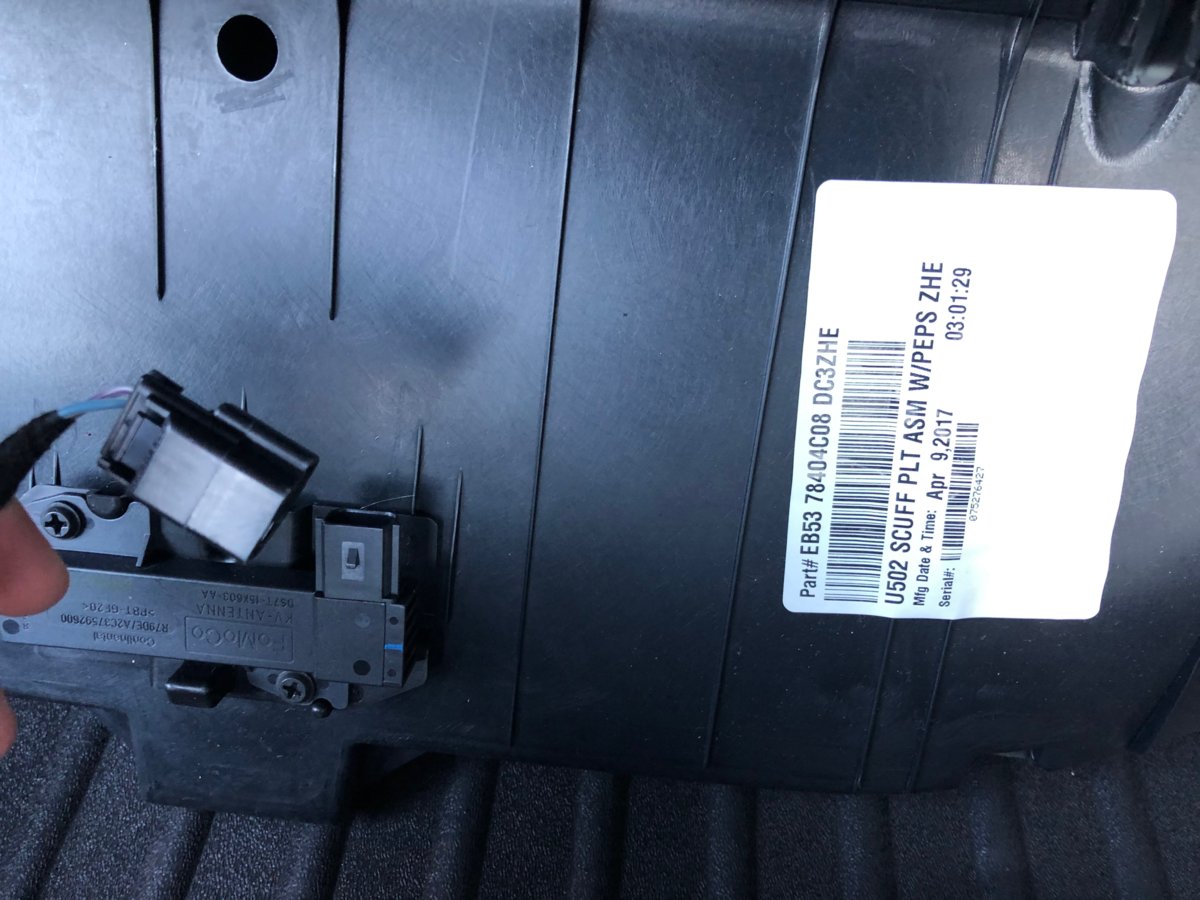

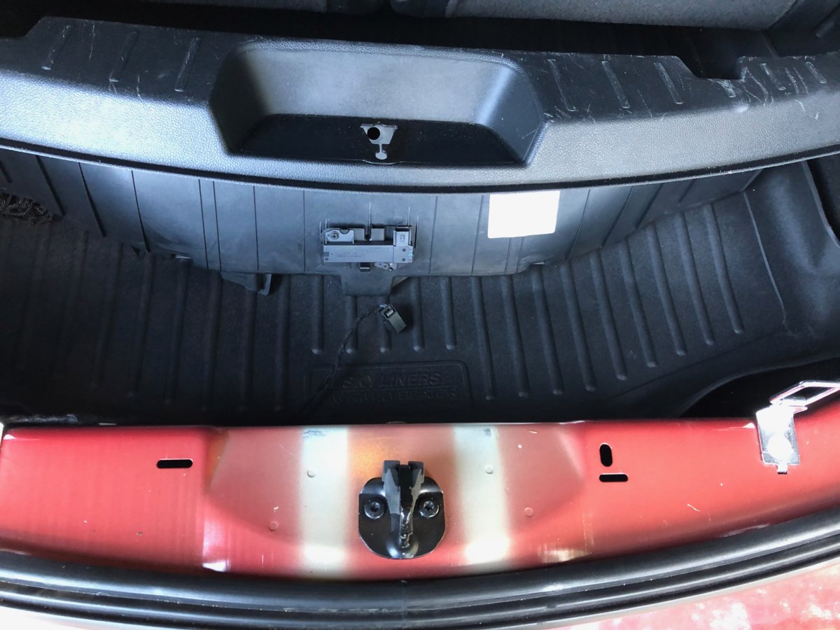

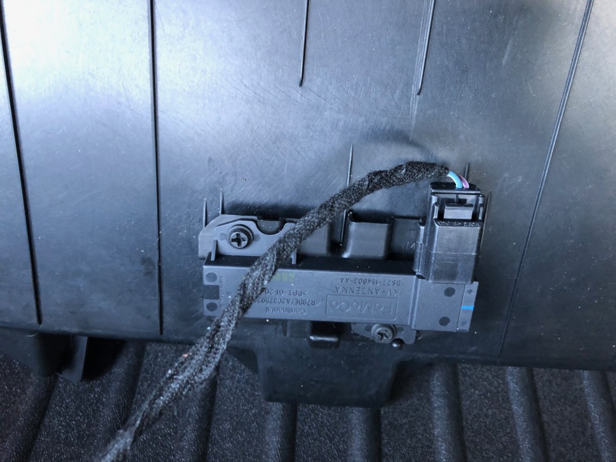

Try the rearmost panel that goes over the bottom latch. Inside is a connector. When that is off, the front button works but the liftgate button and foot sensor doesn't.
You have to take off the piece that gets removed to get out the spare tire. Then the big panel pulls out.

You are a genius!
That's exactly what it was. Plugged it in and everything worked perfectly. I can't believe it was that simple. It looks like you have to take off that rear panel to take off the side panels and they forgot to plug it back in. Thank you so much!
