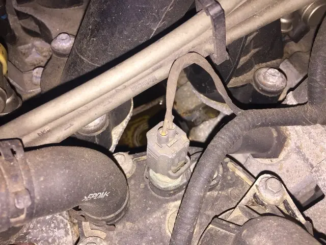

This is what mine looked like: Dried white residue all over it, and the back was leaking onto the engine block pooling up, and burning off as I drove, and dripping on the ground
You can see the pool of coolant behind that wired connector:

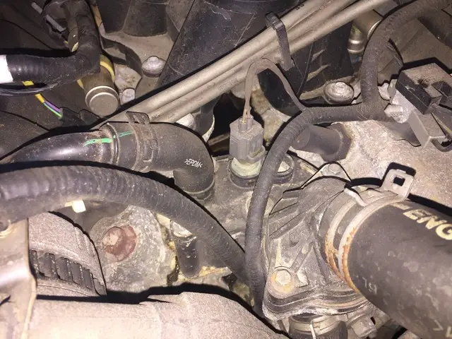

is the first picture you took to the right of the alternator ?
I honestly cant remember at the top of my head, but just follow the large radiator hose, it leads right to it. I believe it is to the right of the alt, but I could be wrong.
Here you go, better picture I found in my photobucket

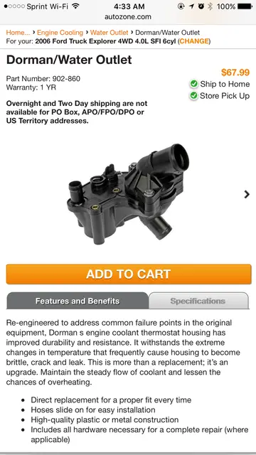

Heres the part itself:
If I remember correctly, I ordered mine on RockAuto for quite cheaper than Autozone had it. Just monitor your coolant level if you don't replace it right away. (If this is your problem)

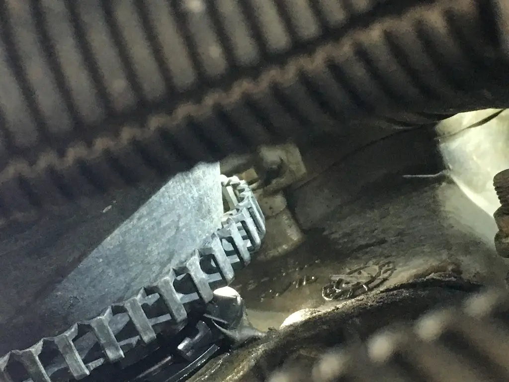

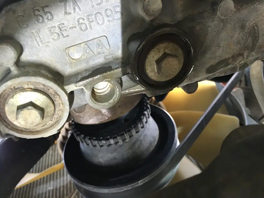

thanks bud sadly my problem of course cannot be simple... the water pump is beginning to leak... only when it cools down so going to wait for it to get worse and then replace it.
I was going to say check the weep hole on the bottom of the water pump and see if its wet but sounds like that is the problem
