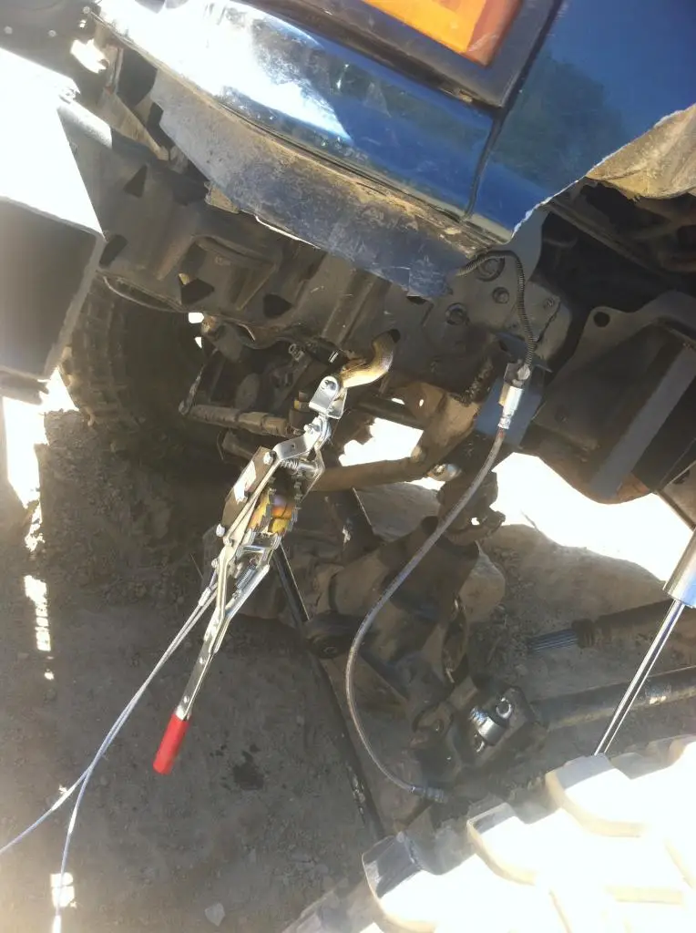

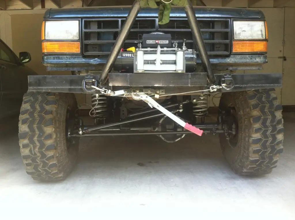

well i finished my sas with the dana 30, went wheeling a few times, and riooed the front axle out. had the 44 sitting on the side of the house for a few months, and now its installed
i used balistic fab radius arm and coil brackets, fabed up my radius arms with dom tubing for the uppers, and my old lowers. track bar is 1.5x .25 dom, and same tubing for my drag link. i used the stock tierod for now, but plan todo dom for tierod also.

still need toget my 5165s installed and get my front driveshaft lengthened.
clearnced xmember, to alow the suspension travel.

axle ripped out

What broke? It looks like a control arm mount broke and not the axle. I've been wheeling with my Dana 30 for the past 5 years and the axle housing has held up fine but I'm also running leaf springs.

yeah thats exactly what happend. the stock upper mounts ripped off the housing. it bent my highsteer bars, and broke my brand new 5125s so i opted to sell all the parts and put my 44 in finally. apon removal i noticed that my lowers where tearing also, so it was a good time to swap it out.
the only issue i had running that dana 30 was it kept eating through ball joints every wheeling trip but i think that was due to the 36s. i never popped a shaft either.
