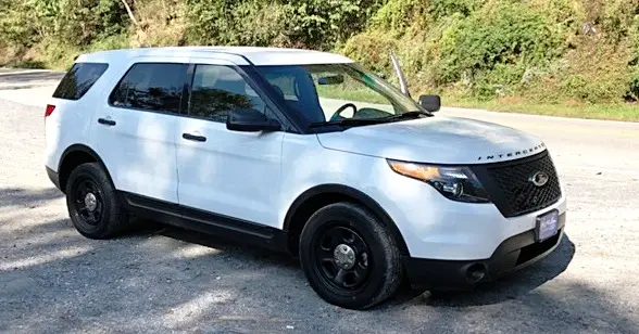

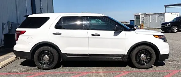

Got the Livenois lowering springs and installed them on new Monroe front struts and put new motorcraft rear shocks in on my PIU. Love the look and feel!
Before
After
Hard to tell the difference from your pictures, as they aren't the same perspective.
Did you by any chance take any ride height measurements - front and rear, before and after?
If so, did it match with what Livernois specs (-1.6" FR, -2.3" RR)? I seem to recall other posts here where people put lowering springs on and claimed they only got about half the indicated drop.
Did you get adj. camber bolts in your kit? Did you need them to get the alignment in spec?
