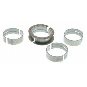

In this set of bearings you will see one set is different, the different set is for controlling thrust from when you put your foot on the clutch. You're pushing the crankshaft forward with a manual transmission. In the automatic transmission models some brilliant person decided to save Ford some money on their motors by using half of that bearing along with the other half of the regular bearings there because there is no clutch pushing against the crankshaft. I found this on two 1991 model year motors. So when a person converts to manual transmission or puts a motor from an automatic transmission into a manual transmission be careful and check this out.
that is just one set of bearings,four per motor.the one that is different is used in the middle and alines the crank,it has material on the sides because the crank rides along the side of the bearing to keep alined.every motor has this.the manual trans model may have a harder material or more than one like this.the difference in a manual trans long block is also the crank,the front crank key design,the cam and i believe it has an extra bolt hole on each side near the motor mounts
