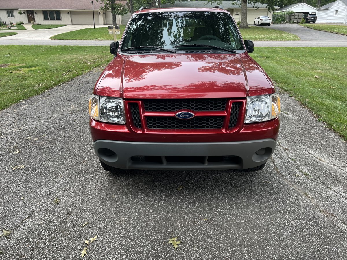

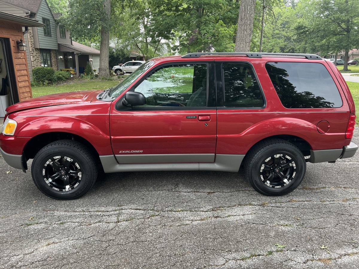

Hi all, I bought my explorer sport 4x4 new, it has 60,000 miles and has been overly maintained been garage kept , very good condition not a sign of Rust
until went to get undercoated and was informed the rockers are rusted. So my question is, worth fixing or bail out now? Thank you.

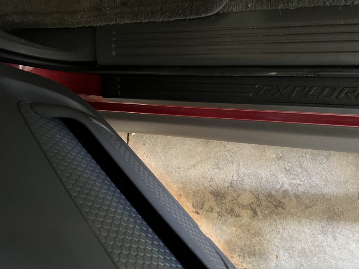

Here are photos.

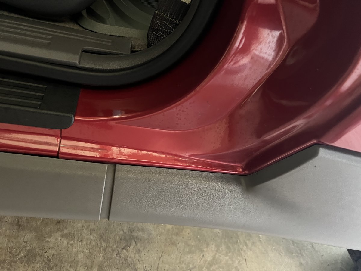

lol! He probably meant pics of the rocker panel rust... though it looks great, especially for its age.
Worth fixing or bail out now? How about option C) which is do nothing except undercoat it as you'd planned to.
I had the rocker panels and doglegs on my '98 repaired about a dozen years ago. at a cost of $1662 which is probably a little over $2K in today's money/economy.
A dozen years later, they are rusting out again, worse than they were when repaired last time. Solution? Do nothing. It's got a full frame that's in decent condition still, no way I'm pouring $2K into that. Engine, maybe I'd spend $2K regardless of it being worth less than $2K. Rocker panels? No. Besides, I can't even see the rust on yours due to the plastic(?) cladding?
On the other hand with only 60K miles on yours, I might just spend the $2k depending on how much the rest of the undercarriage has, or hasn't, rusted. Getting rid of it due to this (alone) is the one thing I wouldn't do.
I don't know why but the 2 doors LOVE to rust their rocker panels.
My friend has a 00 Sport 2dr and the rocker panels are cooked.
Truth is from what I usually see, the rockers rot out but then the rest of it is entirely "fine." especially the frame and anything that really matters. I would maybe check for secret rust like up on top of the gas tank, make sure connections around and on the 4wd motor aren't crusty, check crossmembers, check shackles, etc. Have whoever is doing the undercoating (a fine choice might I add :]) to take a look at any places where sand and rocks and mud would like to sit. That's where I see the most rust usually and where it ever manages to eat through to the other side and make rot holes.
I'd honestly ignore the rocker panels as long as you undercoat them.. As long as they're correctly prepped and undercoated, the rust should slow down almost to a stop if not a complete stop.

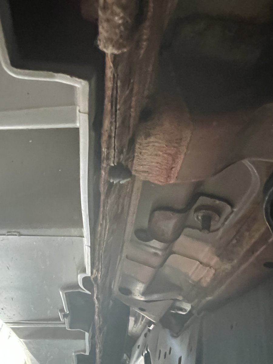

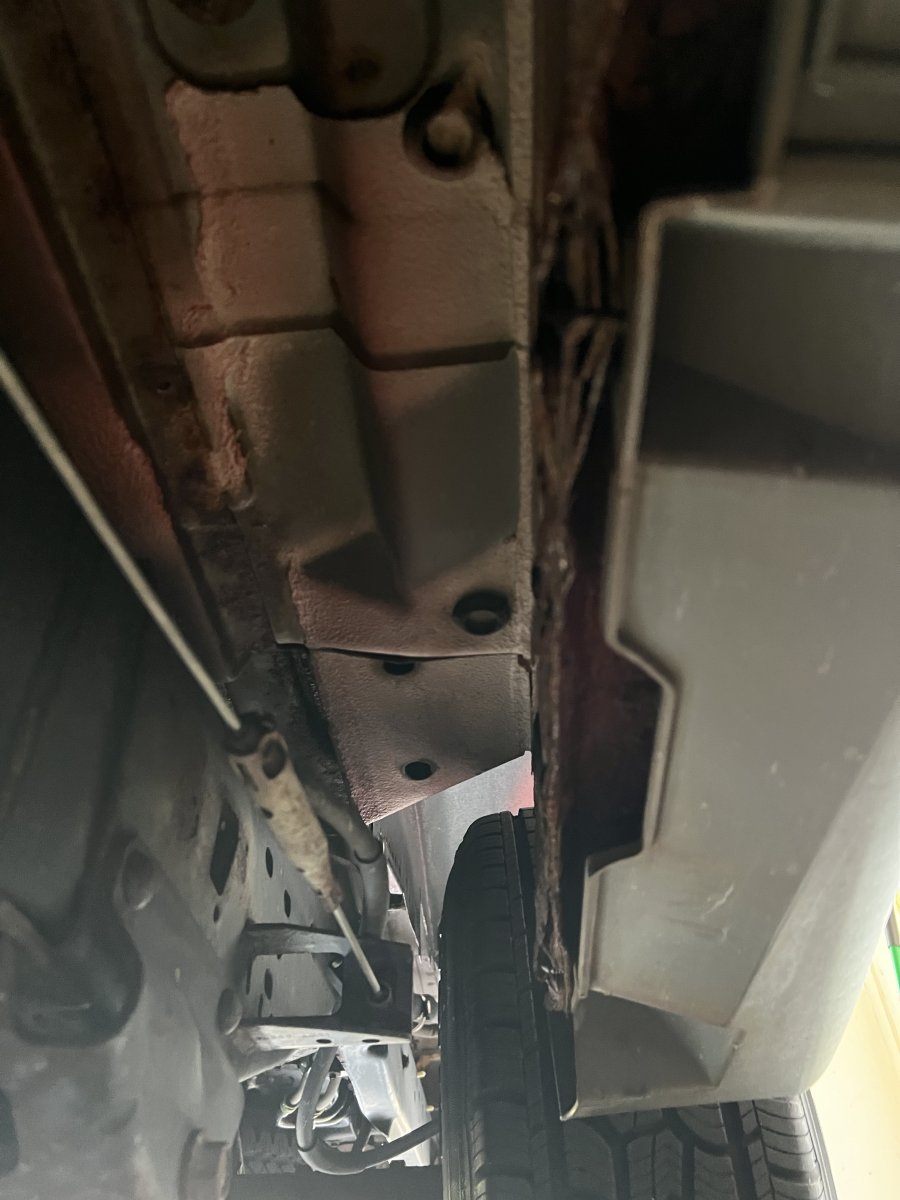

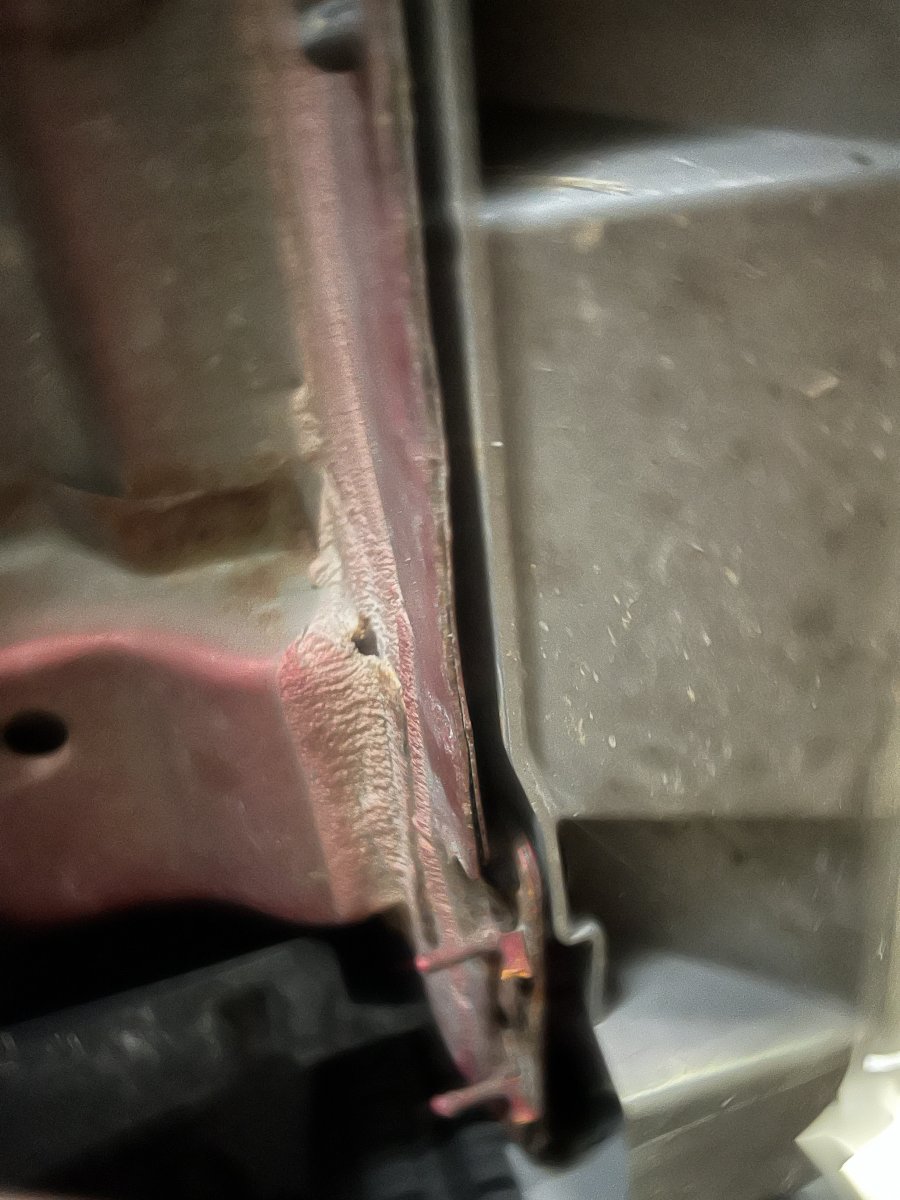

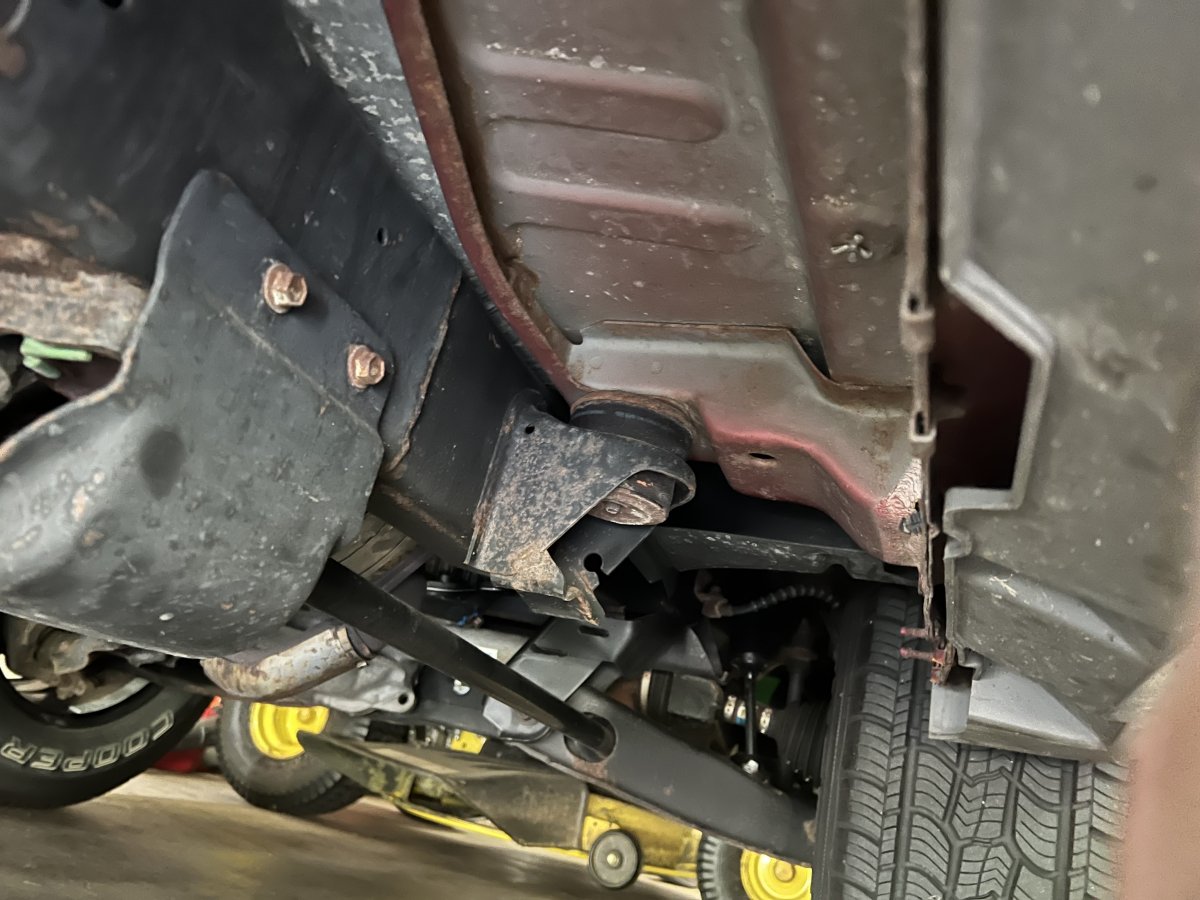

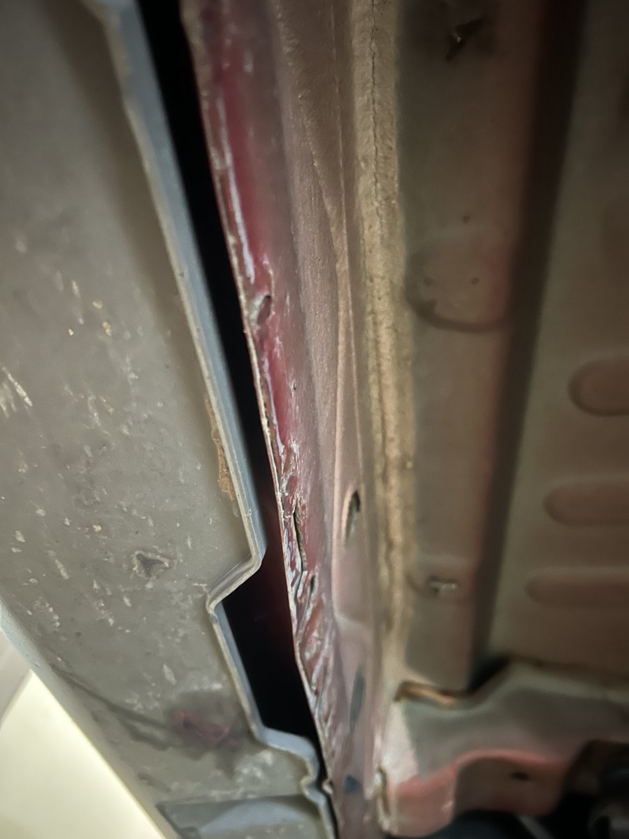

Thanks for all the replies, these are the best pictures I could get.
You don't a have a problem yet. It looks like surface rust. For the split seam, used seam sealer and spray black paint over it. Any rusted surface , use por 15 rust treatment and coat with black paint.
The running board mount are good shape.
I don't see a big problem just surface rust
Use the rust proof system you like and drive it
