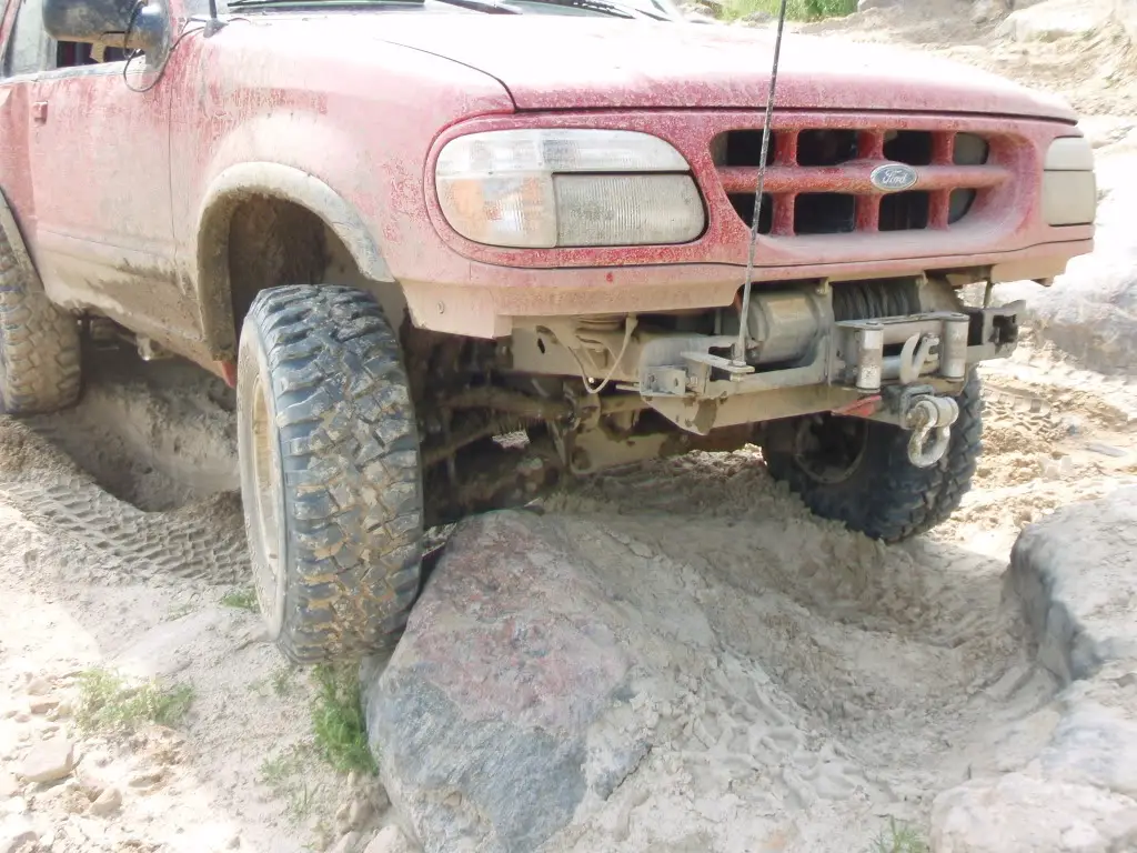

I am using steel. I want to mount the winch behind the bumper. Right now I have a trailer hitch mount on my B2 front bumper and the winch goes into the trailer hitch. The downside to that is the winch sticks off the front of the truck and always gets beat on trees or the ground when going up or down steep hills.

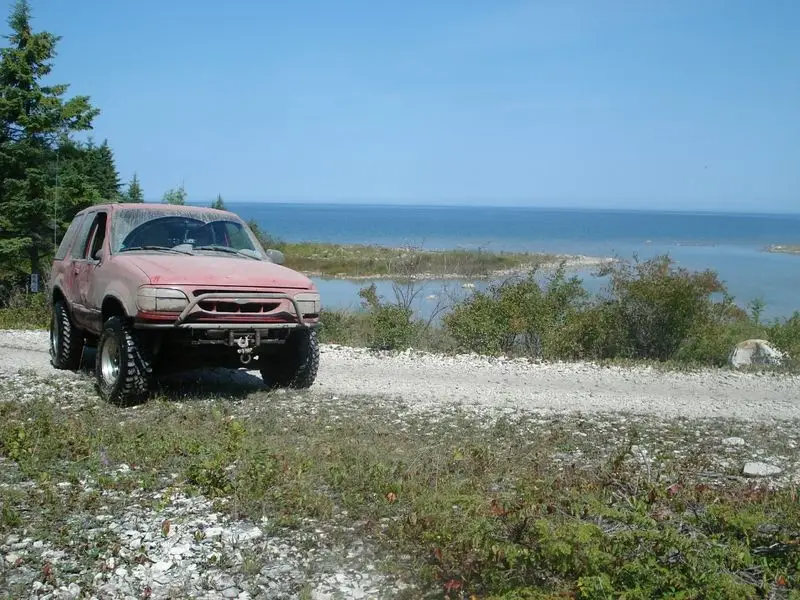

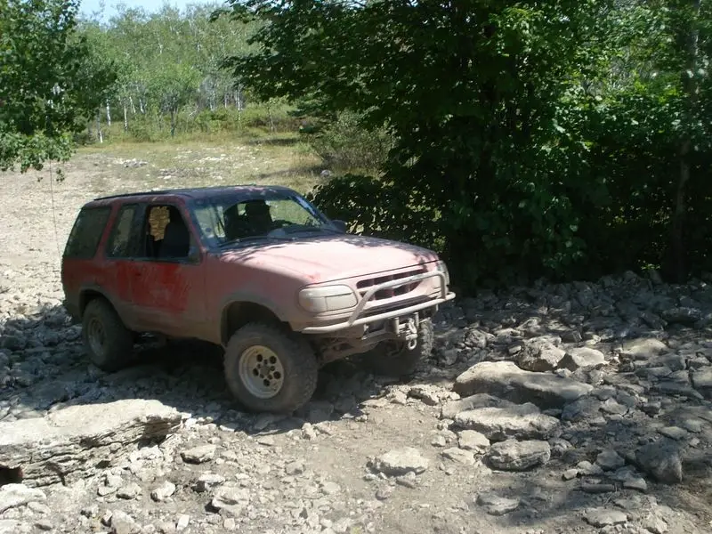

This is the bumper on my 97, it is a very solid bumper. I do like it but I am going to be changing it some because it does stick out more than I like

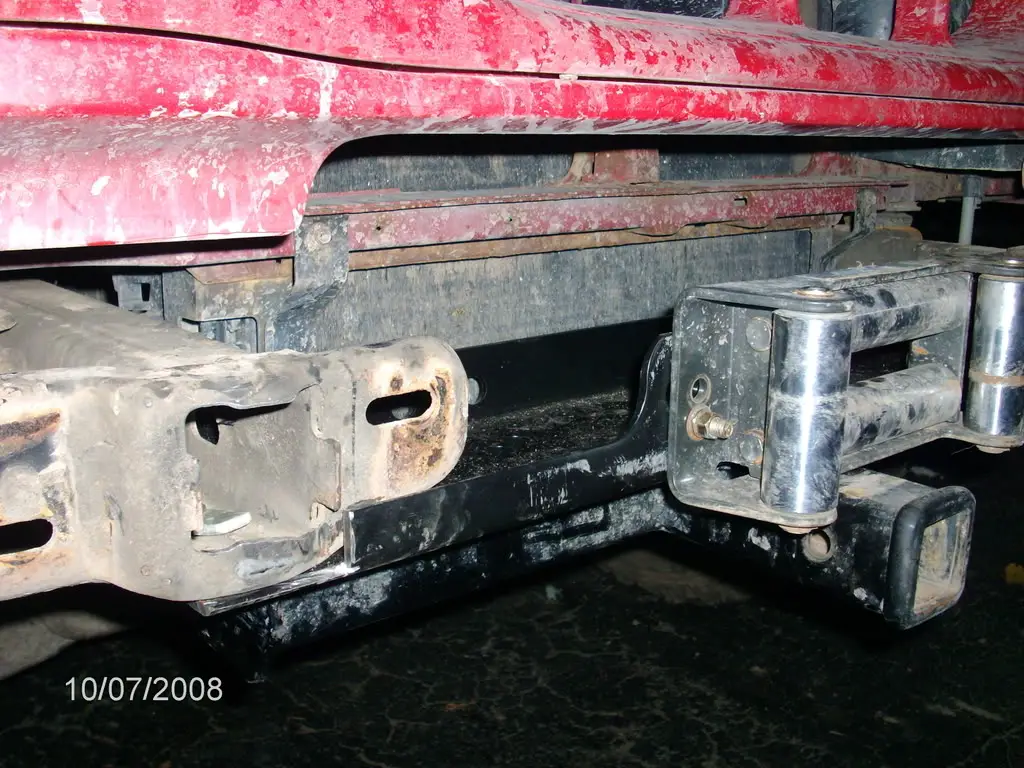

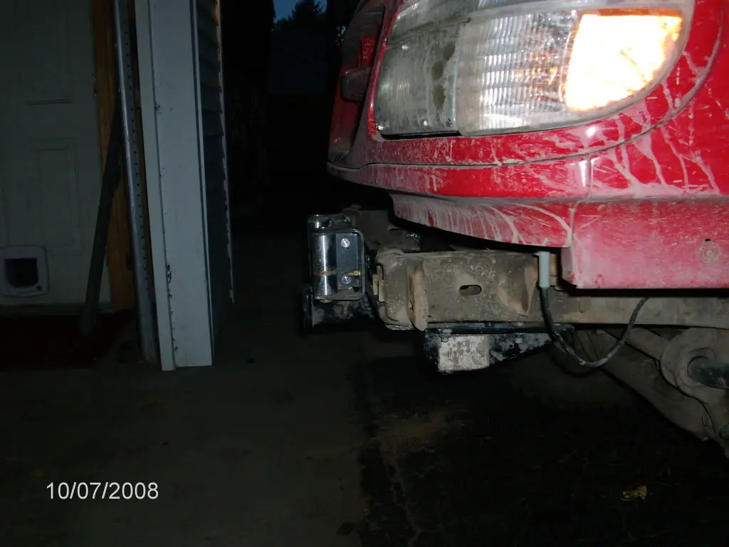

I ran without a bumper for 4 or 5 years. I made a custom winch mount out of the generic Harbor Freight Jeep mount. The custom carrier plate is bolted with 4x 1/2 grade 8 bolts, the same bolts that hold the front reciever in place.
I originally designed the carrier to house the winch behind the stock bumper, and it worked, but was a PITA to engage the winch, so off with the bumper.

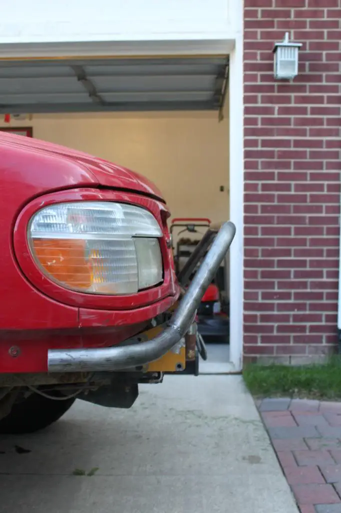

Flash forward a few years, and I was sick of bashing the front end on trees and such. After replacing a headlight, I decided I needed more protection. I made it myself, though I did need to use a good friend's bender (and knowledge of bending). I added a wide hoop to incorporate a 30" LED light bar... my wife tells me it will be awhile before I can afford one though.
These were in the building stage.

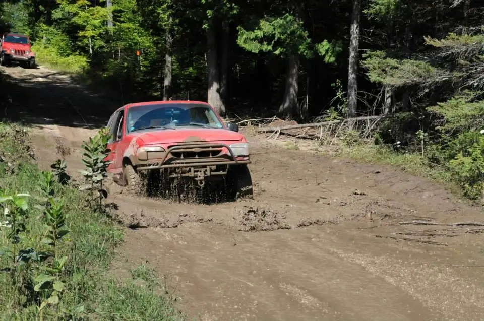

This is what it looks like in action. I scrapped a tree and removed paint off the left side of the bumper within an hour of it's first use lol.
