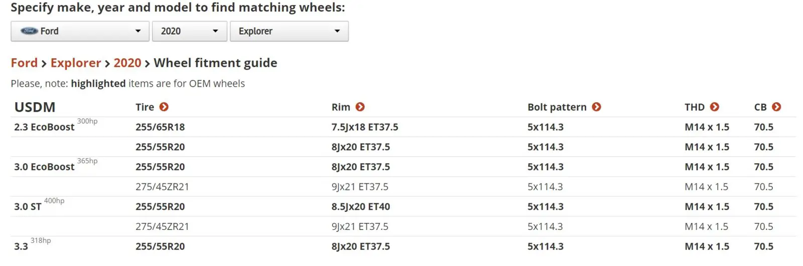

Have an Atlas Blue ST with Street Pack 21 inch wheels on order. Wondering if anyone knows the OEM wheel specifications: Center bore, bolt pattern, rim width and offset. I would keep my aftermarket Touren 20 " wheels from my 2018 Explorer if the specs are the same.
Thanks for your help.
Jacob
Very late, but here ya go...via www.wheel-size.com:

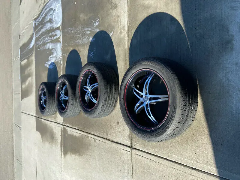

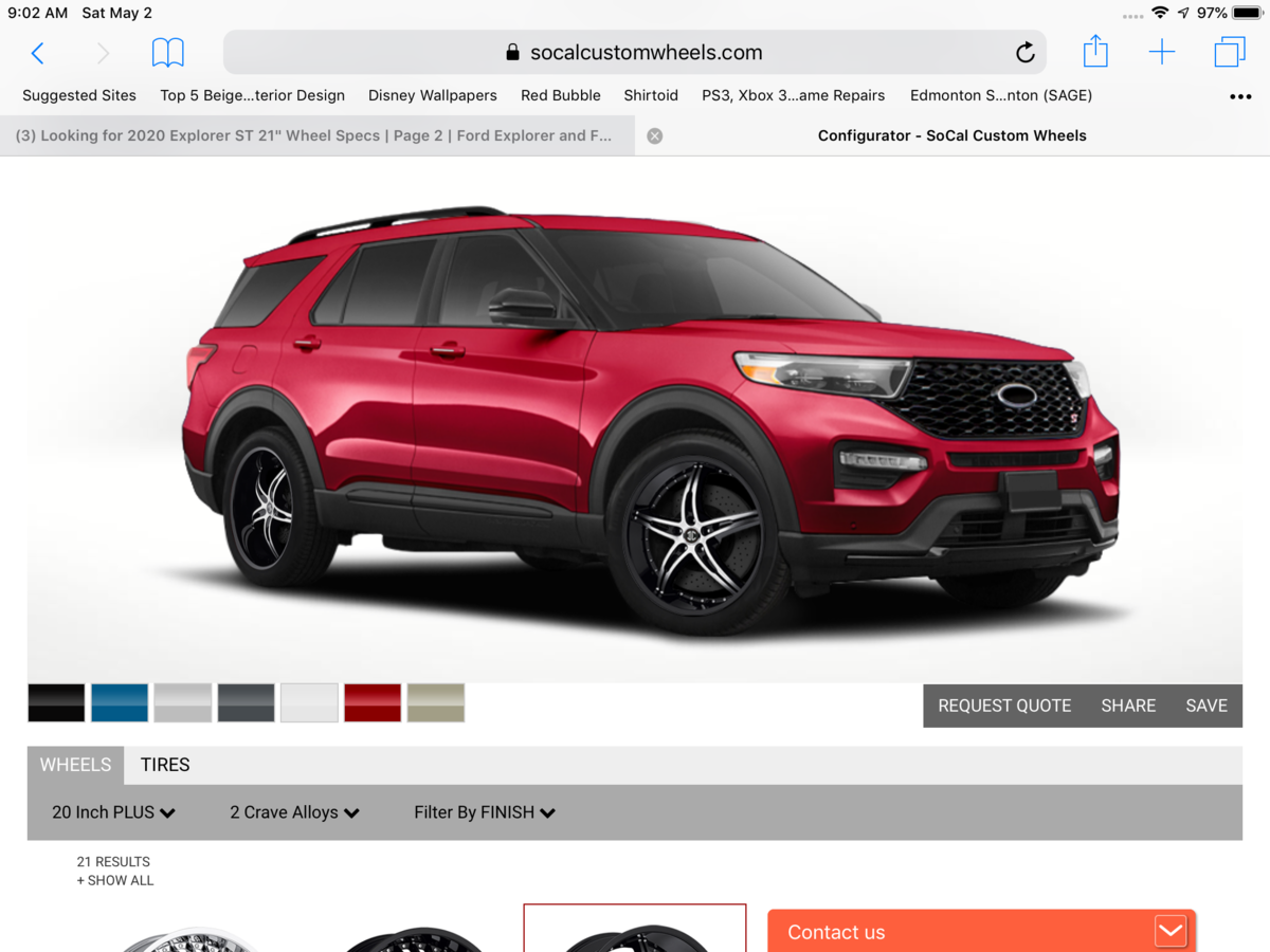

So i automatically assumed that using my 2Crave wheels that i have used on my past (2014, 2016, 2018) explorer sports was a no go due to the hub size. Then i saw this thread last night after posting a kijiji ad to sell them:
Has anyone tried this approach of using a 1/2 inch spacer with success? I would love to keep my 2Craves because they are not available in the 21 inch that i need to put in my factory tires (the stock wheels are in winter tires that need to come off ASAP!)
Here is a pic of the 2Craves. I think it would look pretty hot,
