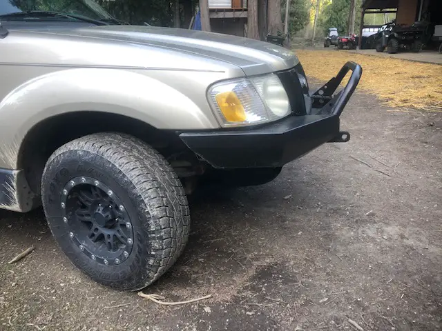

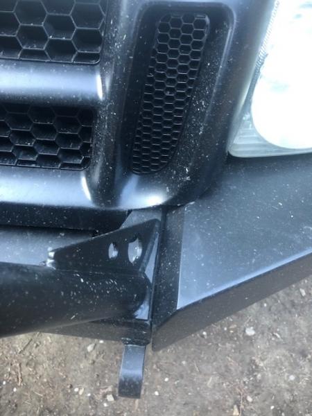

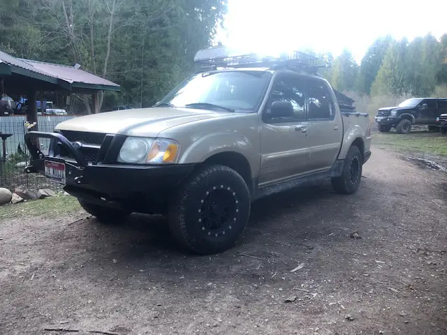

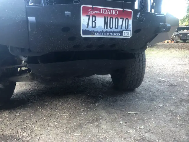

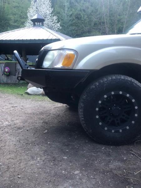

Last weekend I fitted the Ebay Ranger bumper to a 2001 Sport trac. My stepson drives a v8 98 Ranger, his wife drives a V8 01 Sport trac.
Last year the sport trac hit a deer, so it has needed a new front bumper
The 98 Ranger had some weird Jeep bumper on it that never fit right.
So they decided to order two Ebay Ranger bumpers...
It bolted right onto the ranger
To fit the sport trac they enlisted my help (and my welder LOL) I had to raise it up 2" at the mounts, add some heavy duty tabs and a piece of angle iron going from frame horn to frame horn. Hacked the snot out of he header panel (fiberglass) but at the end if the day it fit really really well
Modular Front Winch Bumper with Bull Bar For Ford Ranger 1998-2011 | eBay
I figured it was Rock Ranger who is selling these things on Ebay anyways? Its a pretty dang nice bumper....just needs to move up 2" to fit explorer/sport/sport trac
