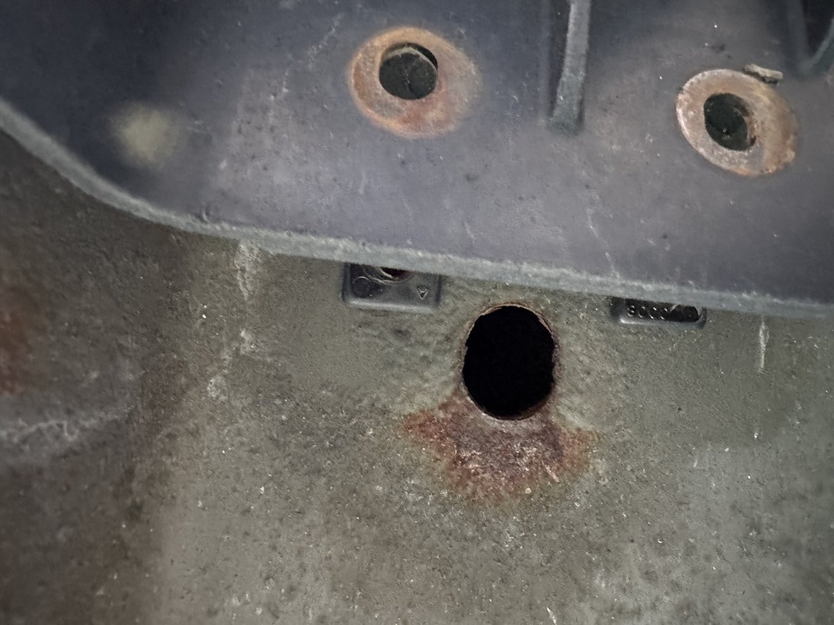

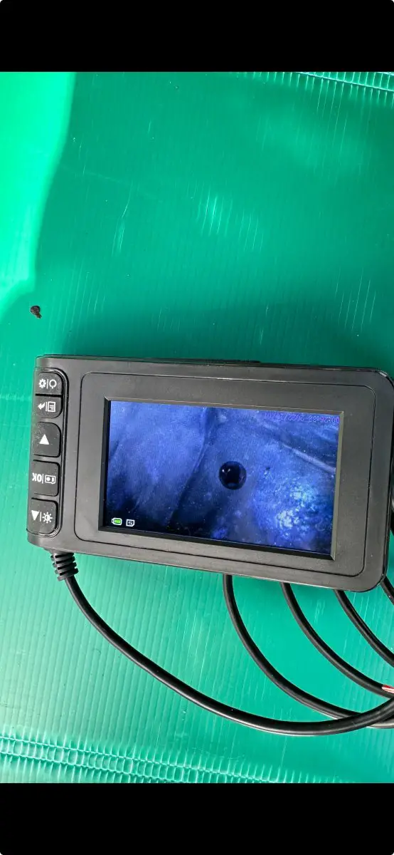

In front of the left rear tire is a small mud flap and all you have to do to access the drain is remove the two bolts that hold this mud flap in place. That will expose a hole in the “frame” and the drain is visible through that hole. This hole is shown in the first photo. To clear the line, I used the black flexible foot-long air nozzle attachment shown in the second photo. I used a few short blasts of low pressure air to clear the line. To get a photo of the drain itself I had to use my endoscope. The third photo is a photo of the endoscope display showing the actual drain. If you zoom that photo you can see a drop of water coming out of the drain.
