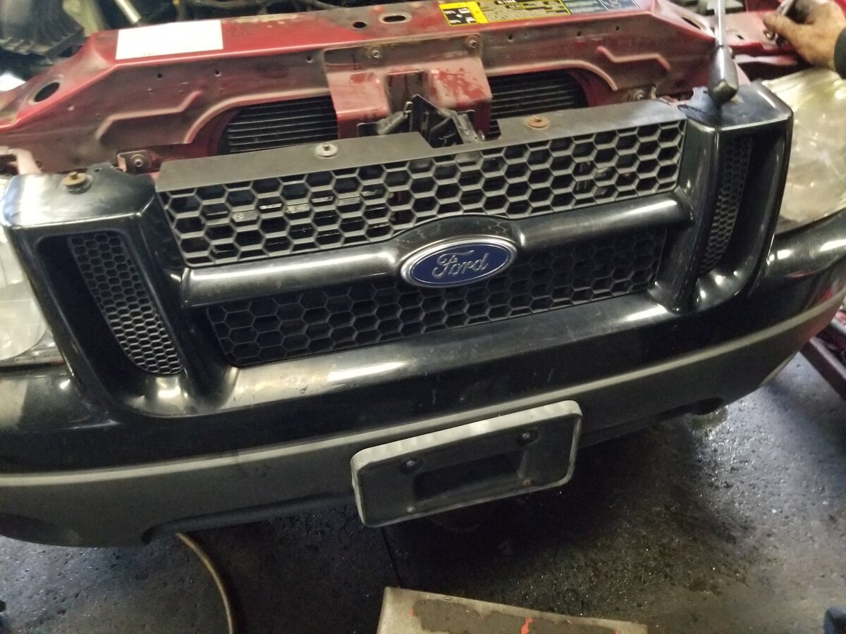

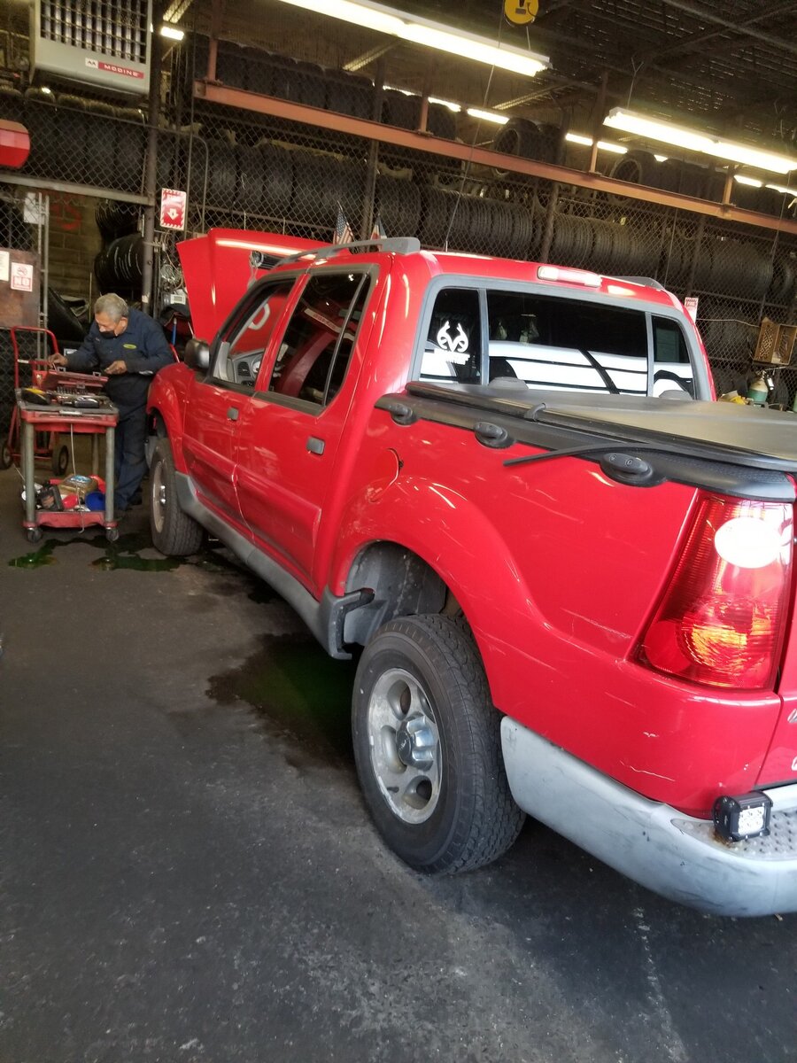

Hey guys so I’m new to the truck community , I landed on a 05 Sport Trac Adrenalin and was wondering about throwing 15” wheels with a tire . Would it fit? I read some thing about the back spacing having to 3 inches ? If you guys have any pictures please post them too ! Sorry about the crap quality pictures my dad took them today
