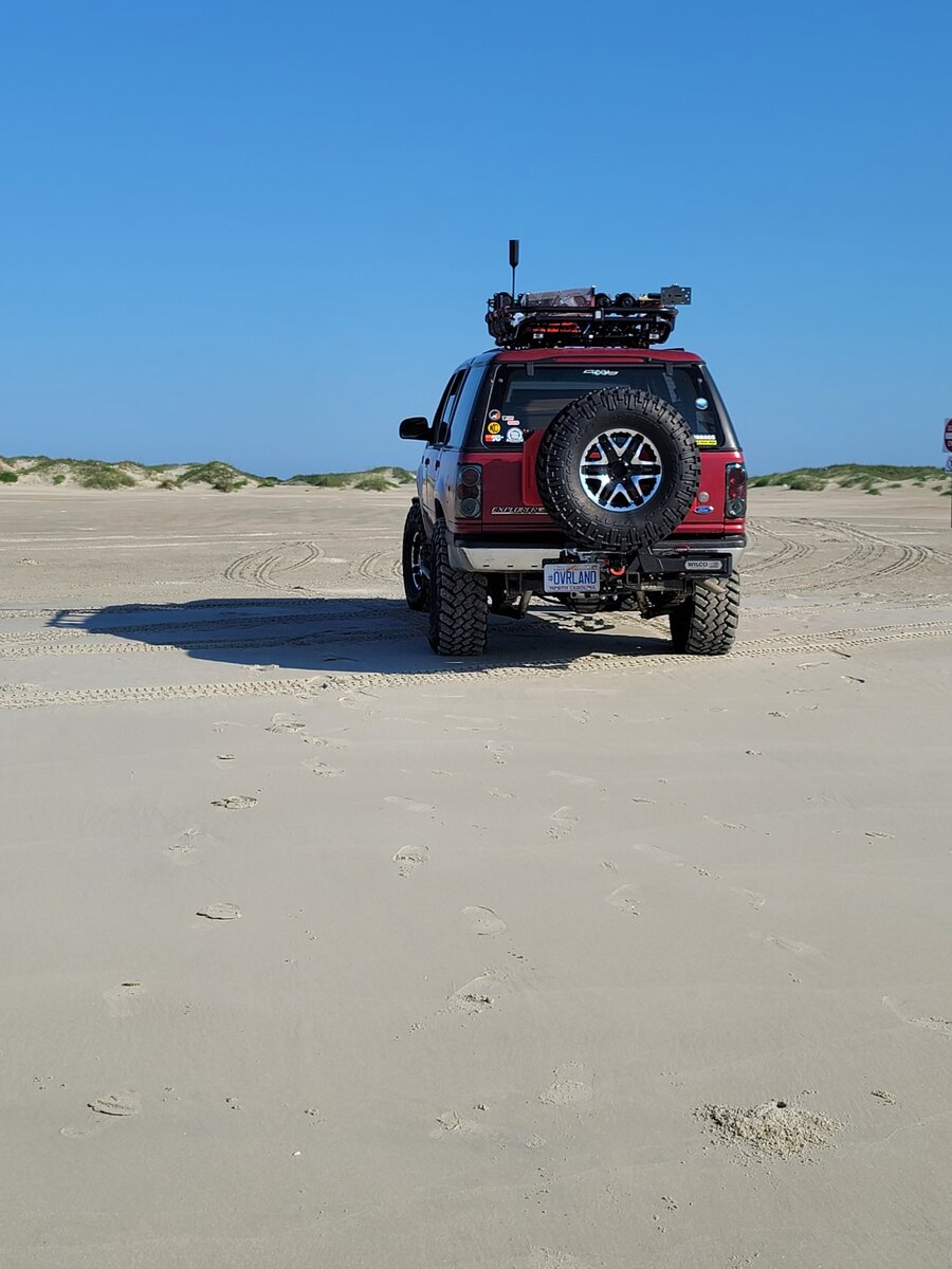

There is also the Wilco mount. Goes in the receiver. It has a pass through so you still have a tow point.
True, didn't even think about that. Those are usually kind of expensive though, if I recall correctly?
I think around a thou... I don't recall exactly. I also added an extra 2" receiver for our bike mount, and the accessory mounts behind the tire for the rotopax, so it was a bit more.
Yeah, that's the price I thought. For that, it's more worth it to me to get an rlc rear swingout bumper, same price basically, but a little nicer in wise of strength. But hey, to each their own, do what ya want. Interestingly done on yours, how far out does it stick with both the tire and the bike mount?

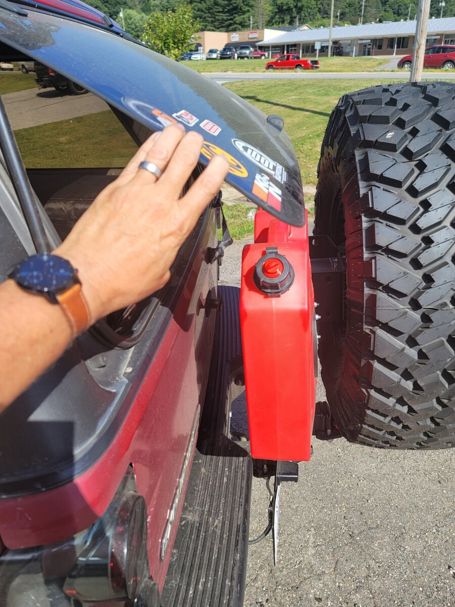

From the tailgate to the outside of the tire is 18". That's a 35x12.5" wide tire also. The bikes add about the same with the carrier.
Also, if need be, I can take the whole mess off in 10 minutes. I can also open the glass without swinging the tire out.
You can open it without moving the tire? Does it really sit that far away?
That's nice
