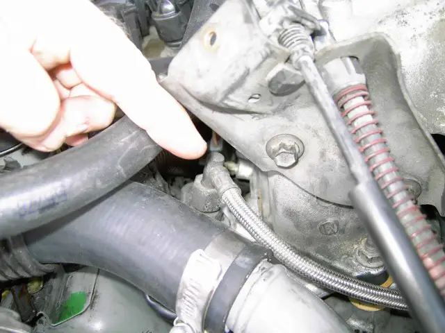

Looking at your pic, as a minimum the FPR line is missing. The attached pic shows the location of the FPR follow the vacuum line back and see if it's connected.
In his pic the :bsnicker: FPR line is right there under the upper intake manafold.

For clarity, the FPR shown in #4 is the fuel pressure regulator, the vacuum line for it is black and underneath.
The vacuum modulator is on the automatic transmission. A bad vacuum modulator is famous for popping the hoses off the tree and spilling ATF on the engine. That would explain the blue smoke.

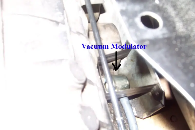

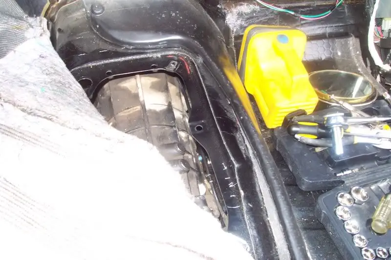

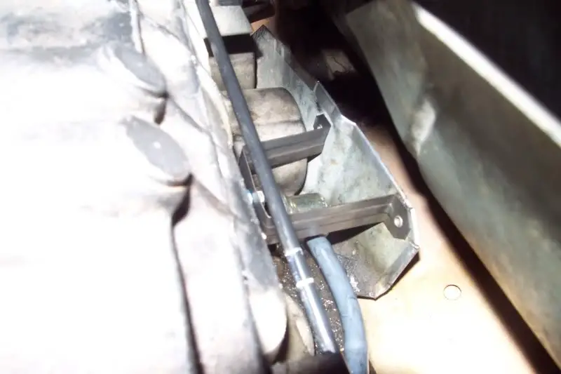

Well that was a pain in the ass. Taking out the seats and console was the easy part. I couldn't get a light in there to see the part while I was working on it. Finally got a 10mm socket on there and it worked great. I wish they would round off the corners of all that metal though, I'm all cut up. I wore gloves after the first major cut but I couldn't feel what I was doing.
Pics of the destruction
This is the right part, isn't it?
