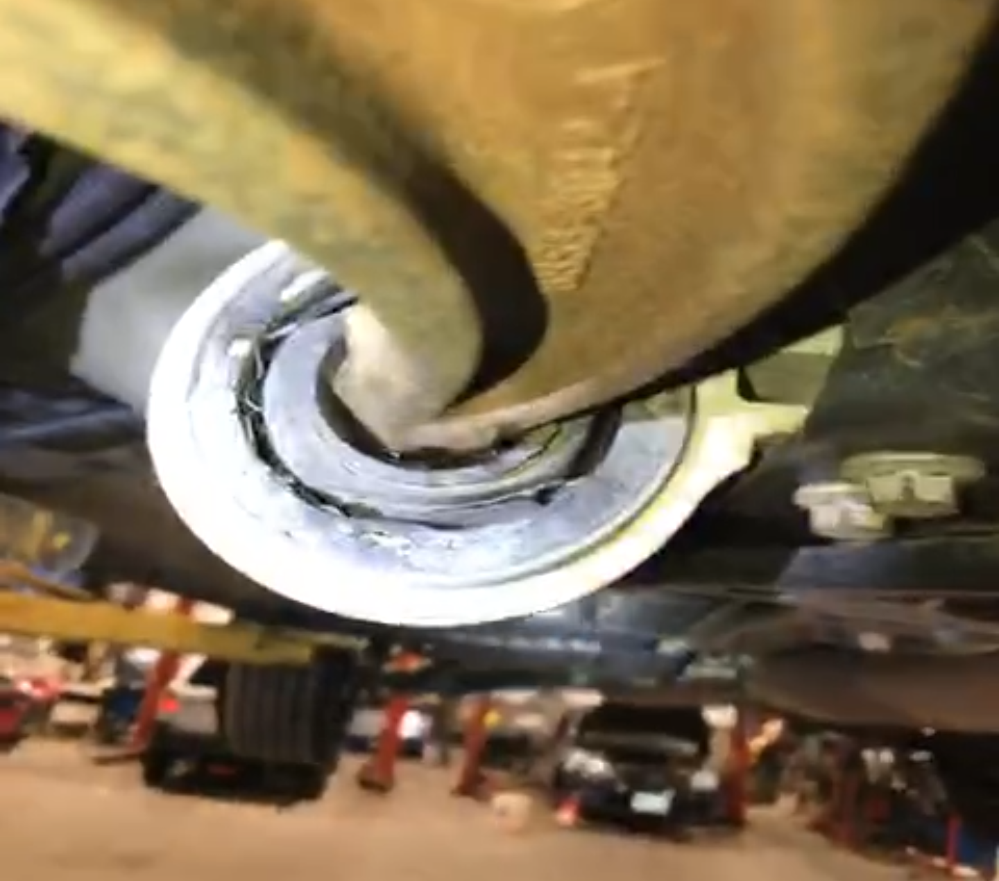

Mine was the lower control arm bushings. Completely deteriorated.
How many miles? And this completely fixed the issue? They found no issues in any part of the suspension and they really really looked through it

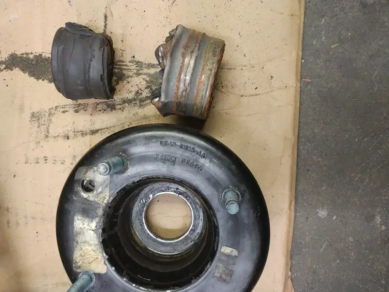

Bad strut bearings? They are terrible and cheap design. I've already replaced three on our Explorer.

if everything looks good replace the front upper strut bearings/mount (same item). They contain the isolator bushings which take up small sharp bumps and ruts before the shocks have time to react and will weaken early due to them being so soft. I had one removed and put in a press and the rubber was peeling away, so they were converted to urethane, haven tried them yet. One thing you may want to try if youre handy with a hydraulic jack is to place the front of the vehicle on jack stands (don't place the stands under the suspension) and remove the front tires, place the hydraulic jack under the front control arm under the ball joint if possible, jack the arm up a few inches and release the hydraulic jack quickly, if you hear the same thunk noise its the from the upper strut mount bottoming out.
When initially hitting a speed bump the top of the strut rod will push the upper section of the strut mount into the shock tower due to the shock being stiffer than the bushing, on rebound the bushing will bottom out also causing the double thunking noise, not saying this is it, but might be.
The other way to check them is to place a video recording device with a light under the hood with the rubber plug on the top of the front shock removed and drive over bumps, the noise should correlate with the top of the strut rod moving.
reserved50
April 21, 2005
1,267
56
2013 Sport Exploder
top of mount, that cup is whats attached to the top of the strut rod and isolated from the body of the strut mount
bottom of mount, the cup hits the body of the mount on rebound, that's where the noise would be
the strut mount in a press, the theres a socket at the back pushing out and the other side is the cup that hits the shocks tower on compression when hitting a bump
what happens after you press the cup out and it goes flying, then air chisel out the cup housing to finish it off since I had nothing better to doo_O:hammer:, the rubber in
between was 30-50% deteriorated
63k. It was that causing my noise.

2018 Explorer XLT 3.5L NA
Rubber was smoked. The control arm was bouncing around.
