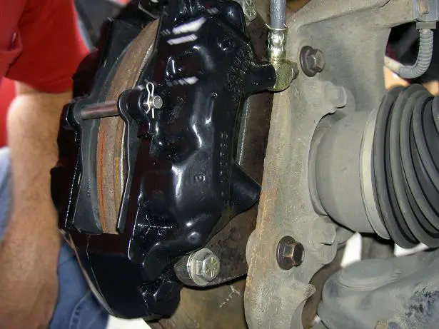

I used those stock bolts in my custom brakes, in each version. Those are great bolts.
I use an extra long 3/8" ratchet for that kind of hard stuff. It's a Craftsman flex head which is longer than a 1/2" ratchet. You need to have that kind of specialty tool in your set.
