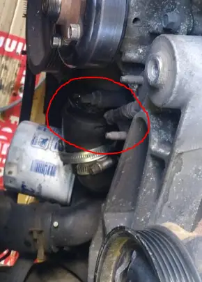

Lower radiator hose? clamp mysteriously broke, and naturally the coolant leaked everywhere.
Now... replacing the old hose clamp i figured would be a easy task, old one out, new one in, easy peasy, job done... oh how wrong was i, first there is absolutely no room to replace the clamp sensibly, the old hose was in still working order but clearly old, didn't want to remove it in fear of braking it, so i installed new clamp while the hose wasn't removed (not the smartest move probably).
I had to remove radiator fan and it's shroud, to which i naturally didn't have any tools for, so i made them... that was an adventure for sure, got it all out and new clamp installed, but question remains, what is the name of the hose (pictures below), also picture of the broken clamp (how does that even happen).

I think we're speaking of the maybe... 5" hose to oil cooler assembly?
What's the diameter of the hose, i assume i have to cut one to lenght, if i intend to replace one.

yes 96-97 5.0 explorers use a oil cooler in the lower radiator hose
The short top hose that goes from waterpump to oil cooler is a PITA to replace, yours appears to be ripped? Has damage below the clamp? At least the pic shows that.
Use stainless made in USA clamps to replace those stock spring clamps.
I have never seen one break like that
I usually delete the oil cooler and run a much more simple design, the 98-01 5.0 explorer did not have the oil cooler
I remove the cooler and hoses, install a 98 style oil filter mount and 98 style lower rad hose
The oil cooler can fail internally when it does you get oil in your water or vise versa (oil pressure usually higher then water pressure)

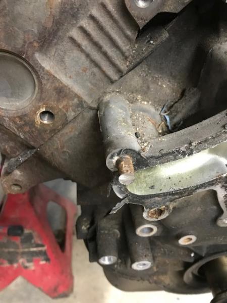

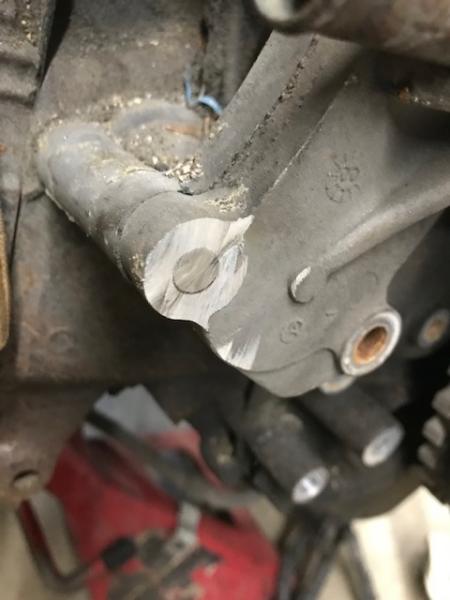

fun fun waterpump/ timing cover bolts
Exposing the broken stud, there are 4 bolts that go through the WP and timing cover and into the engines water jacket = corrosion. 289/302 has always been this way = yuck!
we prep the exposed stud, weld on a piece of flat bar and viola! stud extracted. This method has worked for me several times now. I never had much luck welding on a nut, can never get enough weld on the stud. So we found using flat bar works wonders.....
Hope this helps!
