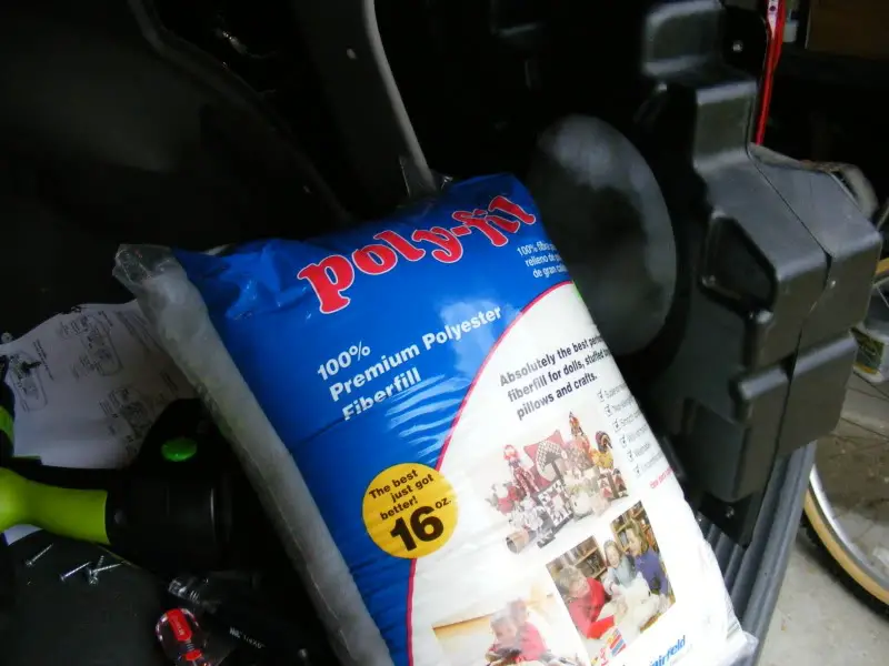

I stuffed my seat with polyfil (pillow batting from WalMart, like $4 per bag- same stuff I put in the sub enclosure), it was awesome. I tried memory foam, but that really wasn't the best thing. All you have to do it pull the seat, pull the seatback off (I also filled the back a bit) and loosen the cover and shove it inside. Not a hard job, I have pics at home...

That was memory foam, so I added more knowing it would compress. I did take some of that out and added the Poly-Fil batting instead. I would recommend that...
Poly-Fil:
Kind of like:
seat surface
Poly-Fil

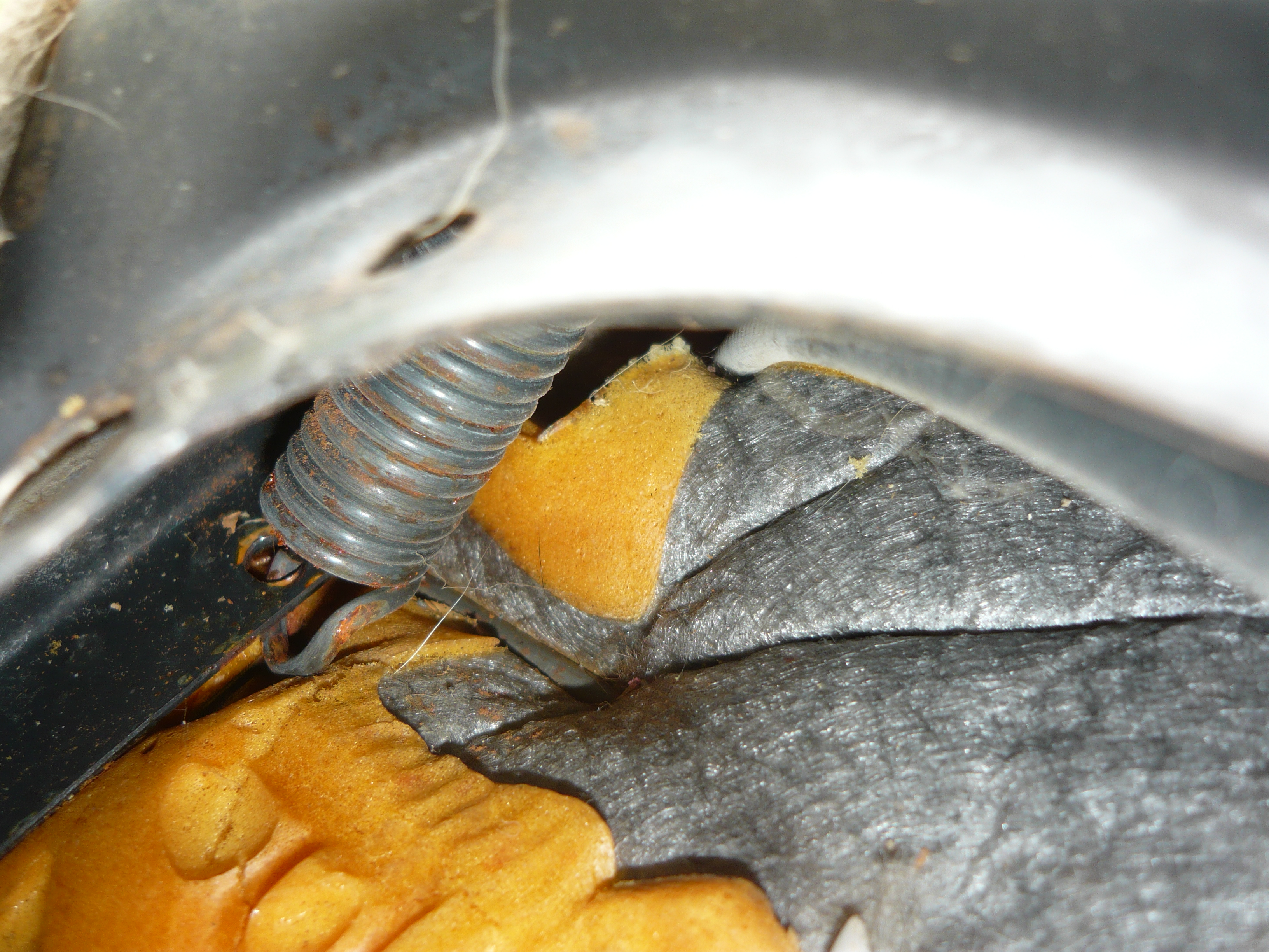

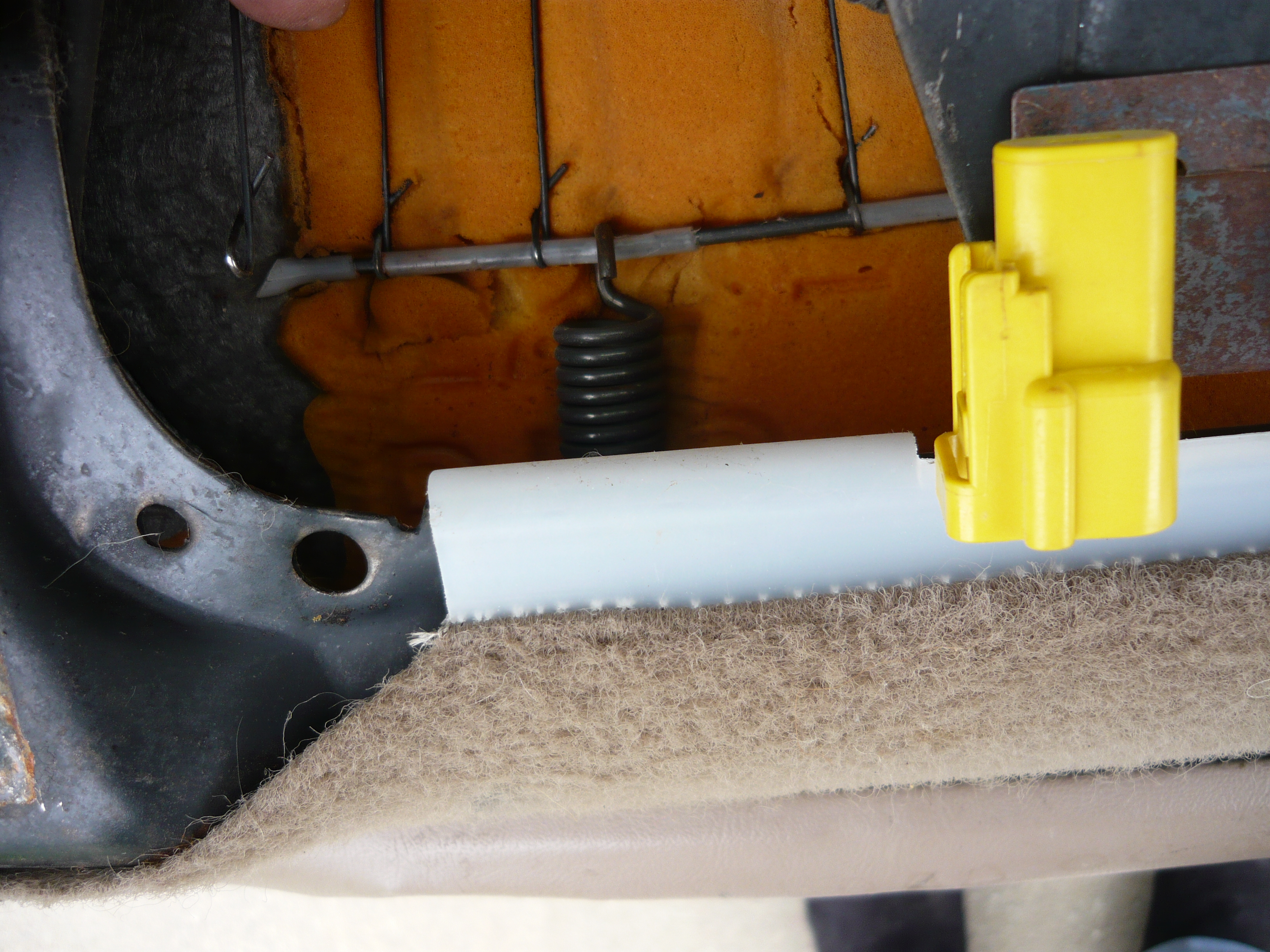

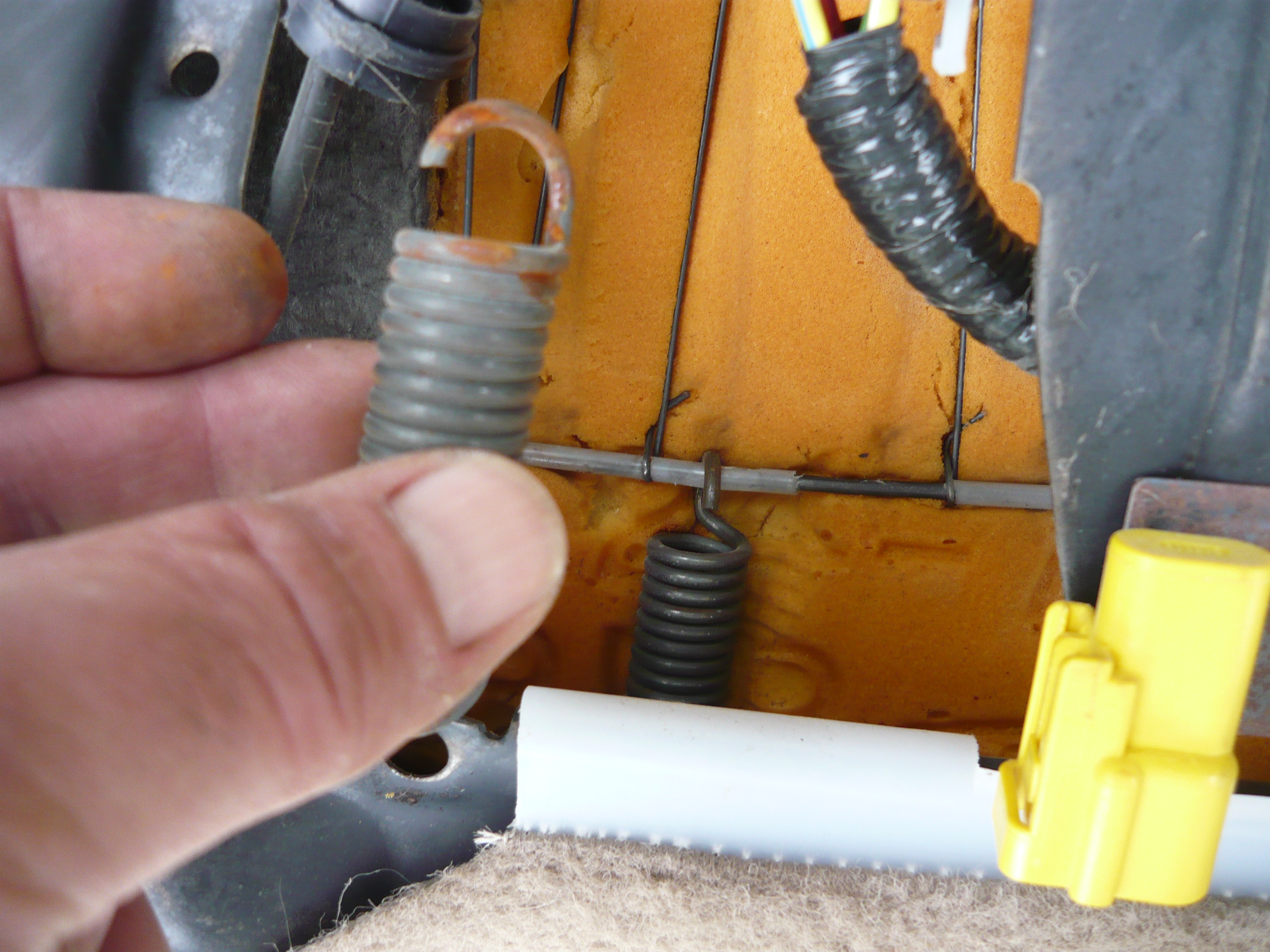

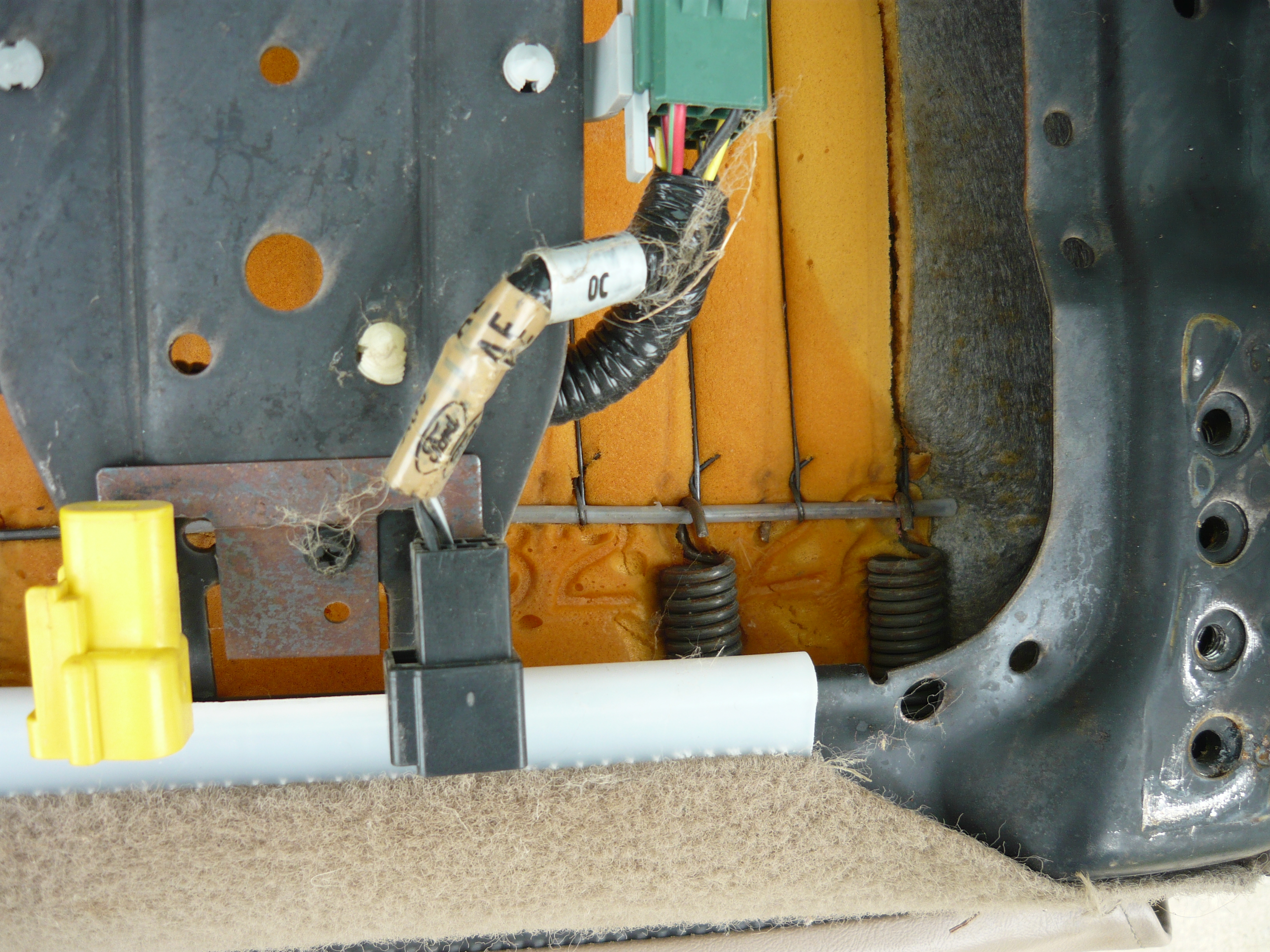

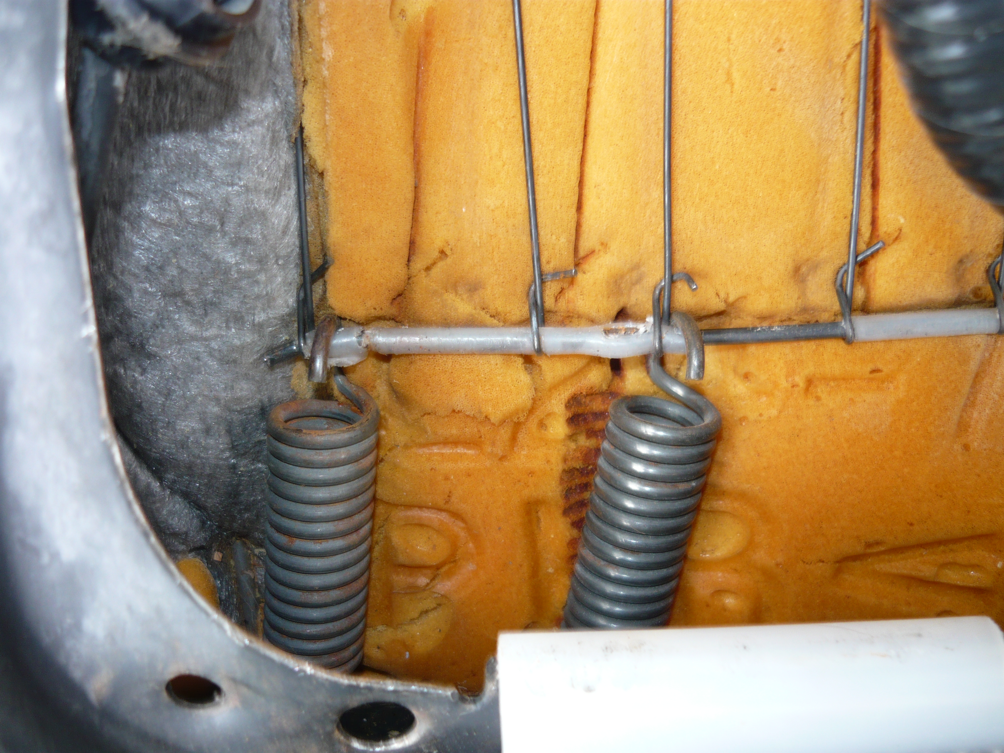

wire and spring slid off the inboard end of both front seats. This was the root problem causing sore ass.
I bent the rod downward toward the end to prevent the wire from sliding off and releasing the spring.
I used a floor mat between springs and foam to prevent cutting into the foam. Then used a zip tie to help support the cross web rope.
Tell me what you think?
When I recovered the driver's seat in my '01 EB IIRC I found a spring off too.
I think the piece of floor mat will help the seat have a firmer feel.
The floor mat is genius.
Nice work.
