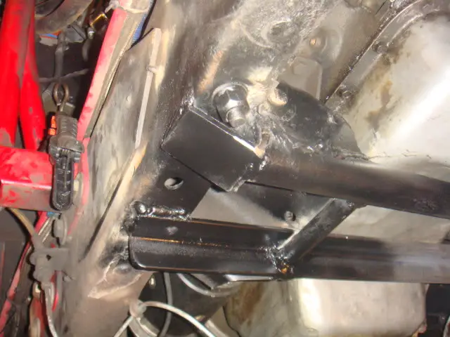

I'd really give this whole idea a second thought. But do admire your exuberance. With that being said I did exactly what your thinking about the cross member but for different reasons. Mine was to put a linked D44 in the front plus relocate axle further forward. When I placed the 302 I re drilled the crossmember for the motor mounts. Then when I built the new crossmember I cut just below the motor mounts. I also used a dual sump oil pan which made the install easier. Future mods on the Xmember is to make it removable so I can take off the oil pan without taking engine out...Need to check on the rod and crank bearings lol.
Here I got most the X member out and the first of two braces in.
Done.
I'd be leery of using the 35 for a front axle and pushing heavy snow. Just google how strong is a d35. My experience was also the fact that the way they're designed it acted like a plow in heavy snow. Last thing is if your really serious about this and not just sitting on the bench a 44 would be a wiser choice unless you already have the 30. Then again the engine your thinking about using may not have to worry about the 30?
